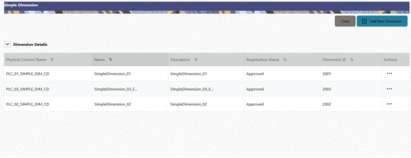

  1. Navigate to the summary screen, and click the Simple Dimensions tile to display the Simple Dimension summary screen.
    Figure 3-2 Simple Dimension summary screen
    This screen displays the summary of the Simple Dimensions and Actions icon.
    The Simple Dimension summary screen displays the summary of existing Simple Dimensions with the Physical Column Names, Name, Description, Registration Status, Dimension ID details, and Actions icon.
  2. Click Add New Dimension to collapse the Dimension Details summary and to display the dimension details.
    When you click Add New Dimension, the UI displays Save and Submit for Approval buttons.
