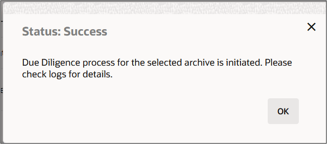

  3. Click Select DueDiligence. The status of Archive is displayed. For more information on status, see Table Status Details. Click Ok.
    Figure 4-25 Status of Archive
    Status of Archive

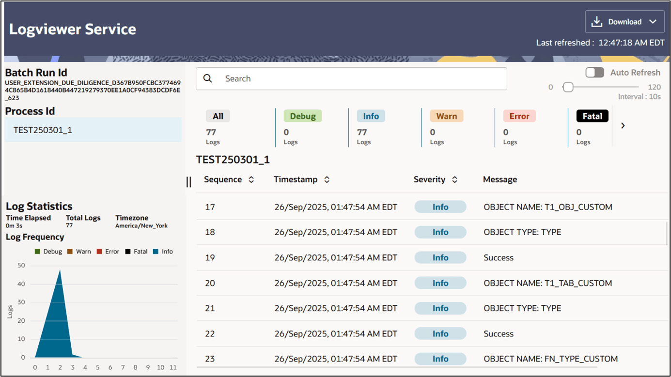

    • View Log: Allows you to access the log details post Due Diligence check.
    Figure 4-27 Logviewer Service
    Logviewer Service
