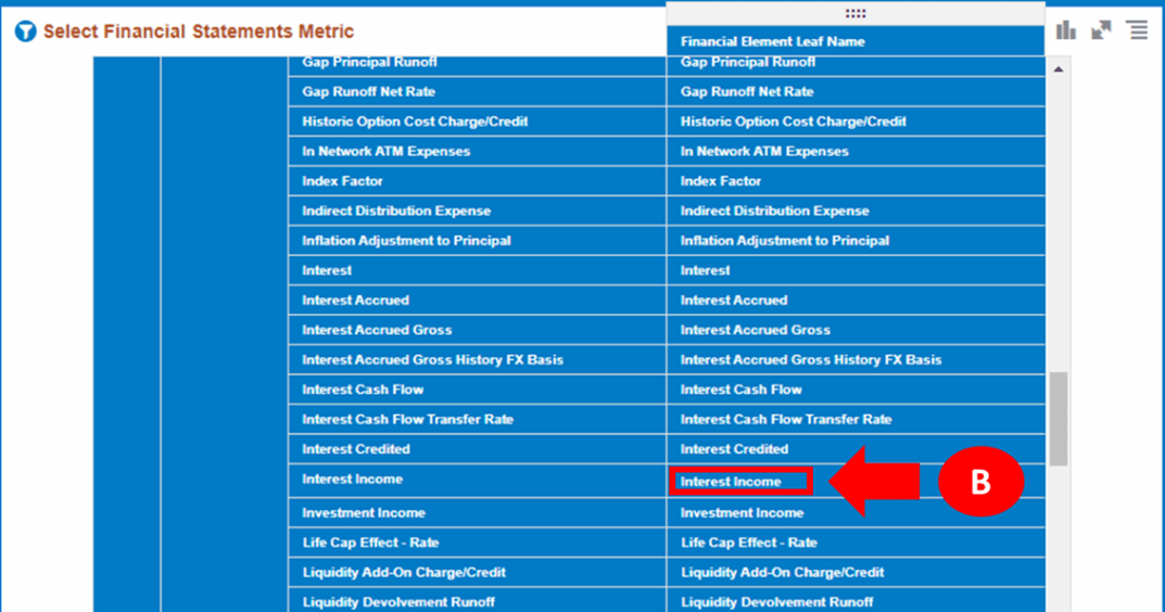

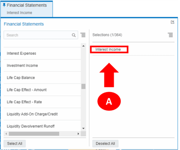

You can either select a single FE Reporting Line via the “Financial Statement” canvas
prompt filter (option “A”) or use the left-hand side “Select Financial Statements
Metric” chart on the “Financial Element Leaf Name” column (option “B”).
Figure 9-180 FE Reporting Line selection Option “A”
Figure 9-181 FE Reporting Line Selection Option “B”
