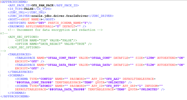

6.4.2.1 Configure the OFS_PAM_SCHEMA_IN.xml File
This section describes how to create database schemas, objects within
schemas, and assign appropriate grants. Specify the database schemas required for the
installation in the OFS_PAM_SCHEMA_IN.xml
. Update the required values in
this file before executing the Schema Creator Utility.
To configure the OFS_PAM_SCHEMA_IN.xml
file, follow these
steps:
- Log in to the system as a non-root user.
- Navigate to the
OFS_PAM_PACK/schema_creator/conf
directory. - Edit the
OFS_PAM_SCHEMA_IN.XML
file using a text editor and configure the values as mentioned in the following table.Figure 6-2 Sample OFS_PAM_SCHEMA_IN.xml File
