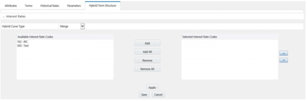

Figure 8-9 Hybrid Curve tab on Interest Rate Code window
The Hybrid Curve tab on the Interest Rate Code window allows you to specify three hybrid yield curves namely, Spread, Moving Average, and Merge.
Hybrid Curve Type: Spread: A Spread hybrid yield curve is defined as the difference between two standard yield curves. The Spread type of hybrid yield curve is useful in establishing liquidity risk or basis risk yield curves.
  • Moving Average: Moving average hybrid yield curves represent moving average data of a single underlying standard yield curve. These curves are used in Funds Transfer Pricing.
  • Merge: Merge hybrid yield curves represent a blending of two or more underlying yield curves. In constructing a Merge type of hybrid yield curve, specify the percentage weighting applied to each of the underlying standard hybrid yield curves.
