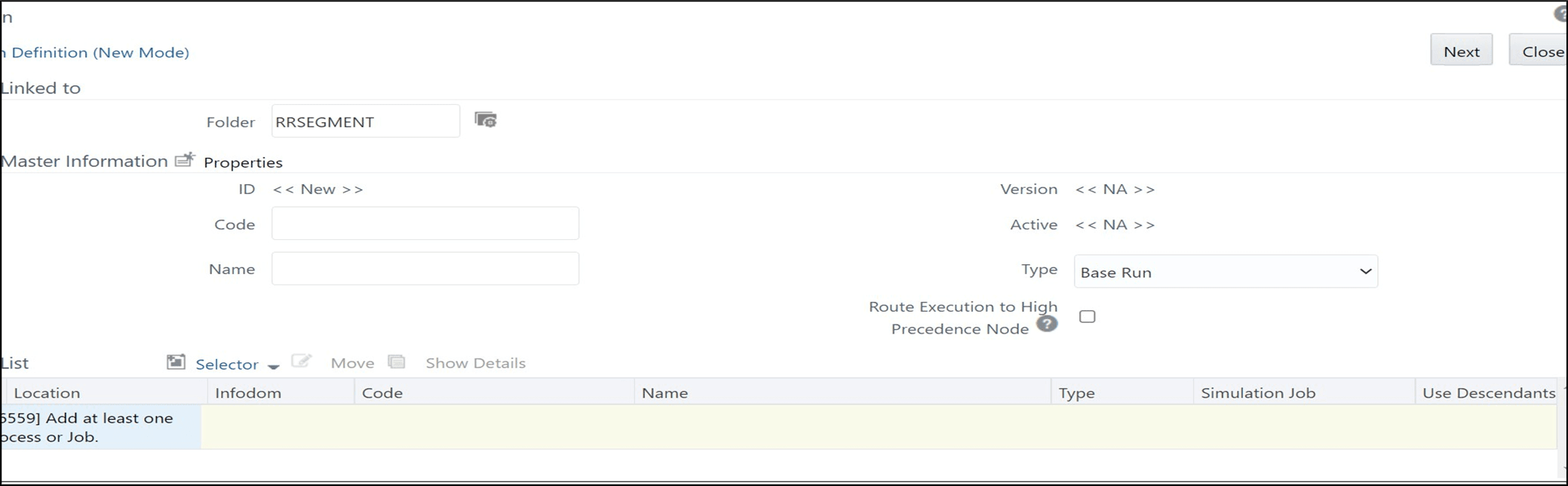

  5. Click the New button. A Run Definition page is displayed.
  6. Click Folder Icon. The Folder Selector window is displayed.
  7. Select RRSEGMENT folder from the list and click OK. The Run page is displayed.
    Figure 7-1 Run page
    Run page
  8. Enter a unique code and name in respective fields.

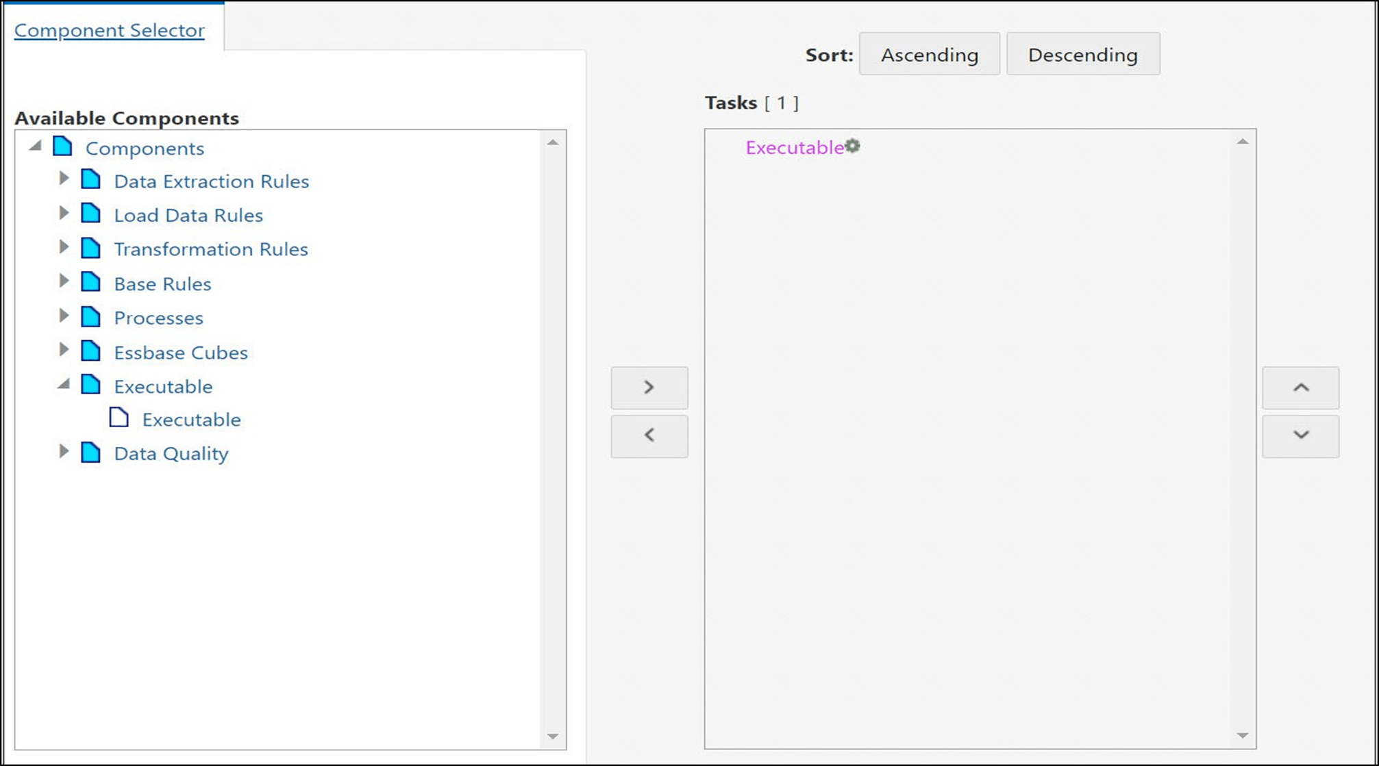

  9. Select Job from the Selector drop-down list. A Selector Component window is displayed.
  10. Under the Available Component list, expand Executable and select Executable component and click Right arrow. The selected component is displayed in the Task list.
    Figure 7-2 Task list
    Task list
