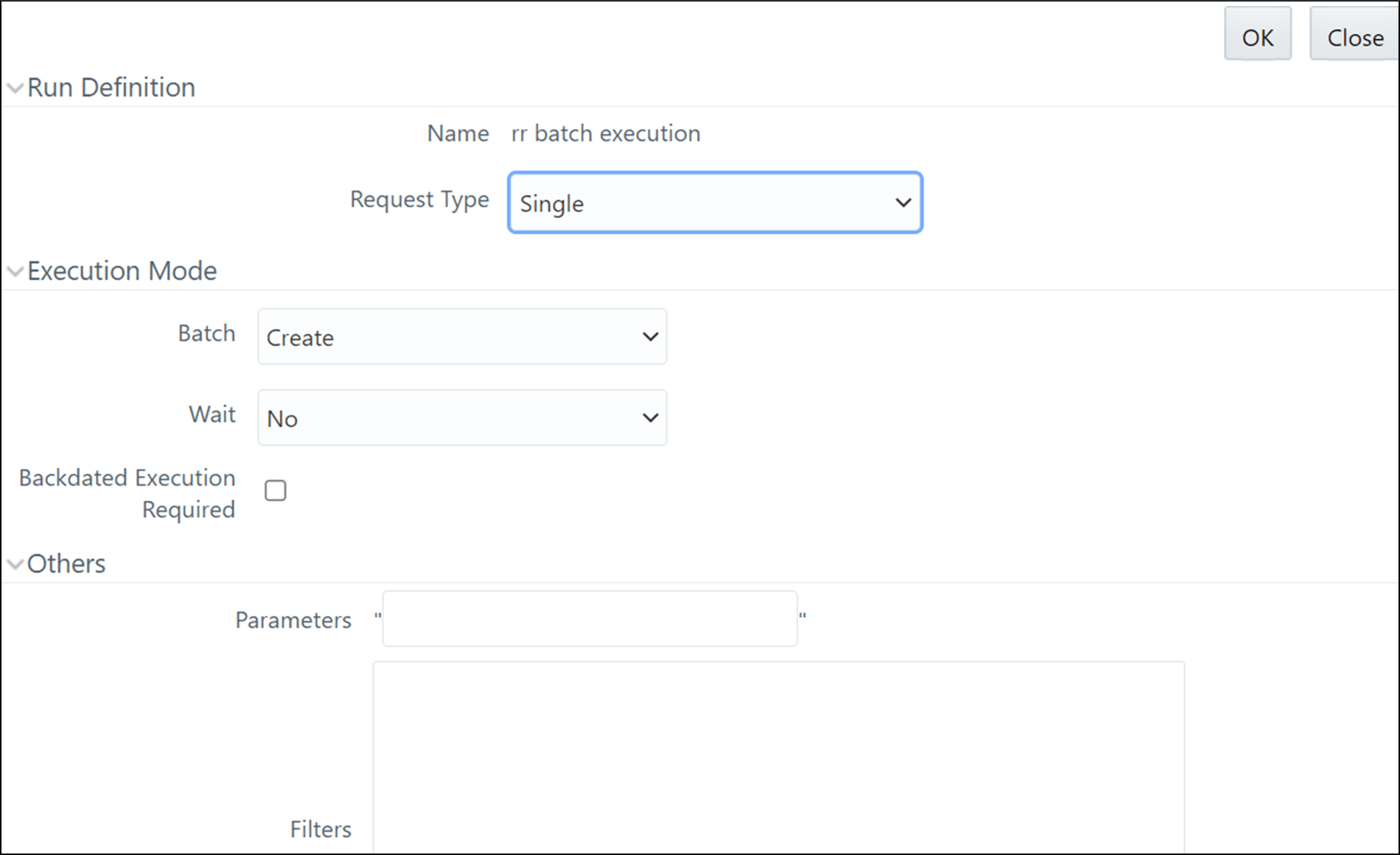

    For more information on how to create and execute Fire Runs, see Operation section in OFS AAI User Guide.
    Figure 7-4 Executing Batches
    Executing Batches
  5. Select Create and Execute from the Batch drop-down.
  6. Set the MIS date and click OK. A confirmation message is displayed. A batch is created and executed for the first time.
