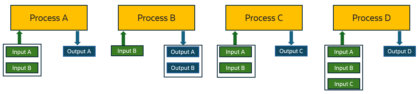

In case of Data Catalog (DC) mode, the processes are run in sequence as mapped in DC.A glossary term on the data catalog has an input and output sub-glossary term. These sub-glossary terms are tagged to processes and models.For example, Glossary terms A, B and C have input sub-glossary terms as Input_A, Input_B, Input_C and Output_A, Output_B and Output_C respectively.
These sub-glossary terms can be tagged to processes and models on the data catalog.
Assuming input_A is tagged to process A, process C and process D and output_A is tagged to process B. Input_B is tagged to process C, and output_B is tagged to process B. Input_C is tagged to process A and process D and output_C is tagged to process C. Input_D is tagged to proceed D and output_D is tagged to process A.This is represented in the below image.
Figure 6-8 Glossary terms example

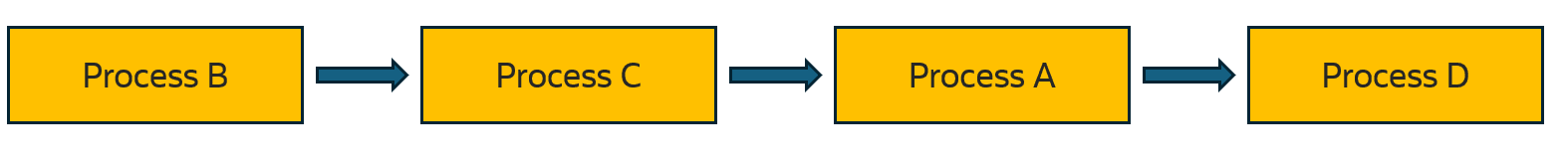

Then, the processes are sequenced as below:
First process B is executed and then process C is executed followed by process A and finally process D is executed. The auto-sequencing is in this particular order since process B is not dependent on any inputs (or process) and can start immediately. However, process C has a dependency on process B (since the output of process B is an input to process C). Similarly, process A cannot run independently as it requires inputs from process C and process A's outputs are an input to process D.
The sequence of process is as per the below image:Figure 6-9 Process sequence example
