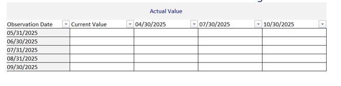

- Observation Date CalculationThe Observation Date column is unique to MEVTS variables and is calculated as follows:- The first observation date is set as the scenario reference date.
- The total number of observation dates is equal to the variable's timeframe.
- The interval between observation dates is determined by the variable's frequency.
- The Start-of-Period / End-of-Period setting determines whether the observation dates align with the beginning or end of each period.
Shock Types for MEVTS Variables
Three types of shocks are supported:
- Absolute Values: Users manually input absolute values in
                    the scenario grid.
                        Figure 6-1 MVETS Absolute Values

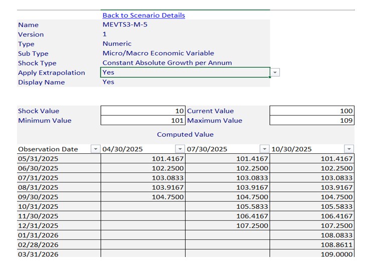

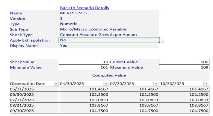

- Constant Absolute Growth per Annum: The formula and other configurations remain unchanged. However, in this case, the values are calculated based on observation dates corresponding to future periods. Minimum and maximum bounds are also applied for time series (TS)-based variables. For example, if the user provides a current value of 5%, the calculation for the first future date (for example, 03/06/2025) will be based on the observation period from 30/04/2025 to 31/05/2025. For the next future date (03/07/2025), the value from 03/06/2025 will be carried forward through interpolation, which, in this case, remains unchanged. As a result, the values across all future dates remain consistent, as shown in the scenario grid. Figure 6-2 Constant Absolute Growth per Annum  Extrapolation Support Users can enable extrapolation to extend observation dates beyond the current timeframe.- A new grid appears with extended future dates.
- The number of extra dates depends on the frequencies of the scenario and the variable.
 Frequency Base Days:- Yearly (Y): 360 days
- Quarterly (Q): 90 days
- Monthly (M): 30 days
- Weekly (W): 7 days
- Daily (D): 1 day
 The formula to calculate this is: Figure 6-3 MVETS Variable formula  Example: If the scenario frequency is Quarterly (90 days) and the variable frequency is Monthly (30 days): Q/M = 90/30 = 3, therefore, 3 new dates are added per extrapolation step. Extrapolated values are calculated using the same formula as defined for the selected shock type. Figure 6-4 MVETS Variable Example

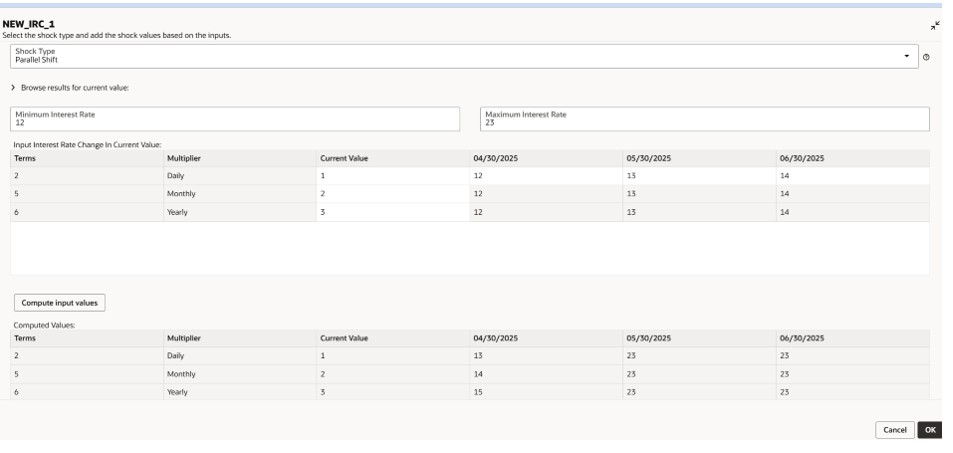

- IRC Variable Grid Formation
                        During the variable creation process, terms and multipliers are defined for the IRC variable. Users can then enter current values, and the system will calculate corresponding future date values. The resulting grid appears as follows: Figure 6-5 IRC Variable Grid Formation  IRC variable also has absolute value shocktype.
- Flat:: the formula to claculate this is as
                        follows:
                        Figure 6-6 IRC Variable Grid Formation  In this shock type, the user provides input only for the current value. All future values remain unchanged, resulting in a flat curve with no variation across time.
- Parallel Shift: the formula to claculate this is as
                        follows:
                        Figure 6-7 Parallel Shift formula  The user may optionally specify minimum and maximum bound values. A single delta value is entered for all future dates and is uniformly applied to the current values. This results in a parallel shift of the entire curve.
