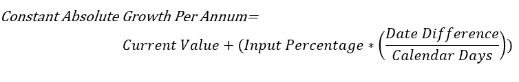

- Constant Absolute Growth Per Annum (CAGPA) -
the formula to calculate this is:
Where,
Current Value - is the reference value entered on the UI
Input Percentage - is the percentage value of growth or deprecation
Date Difference - is the frequency selected.

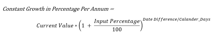

- Constant Growth in Percentage Per Annum
(CGPPA) - the formula to calculate this is:
Where,
Current Value - is the value entered on the UI.
Date Difference - is the frequency for the calculations

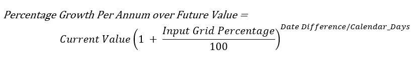

- Percentage Growth Per Annum over Future value
(PGPAF) - the formula to calculate this is:
Where,
*For each iteration the Current Value is updated based on the previous calculation
Input Grid Percentage - is the change per annum
Data Difference - is the difference between the frequency of dates mentioned

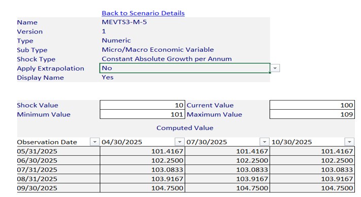

Shock Types for MEVTS Variables
Three types of shocks are supported:

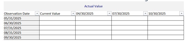

- Absolute Values: Users manually input absolute values in
the scenario grid.
Figure 6-1 MVETS Absolute Values

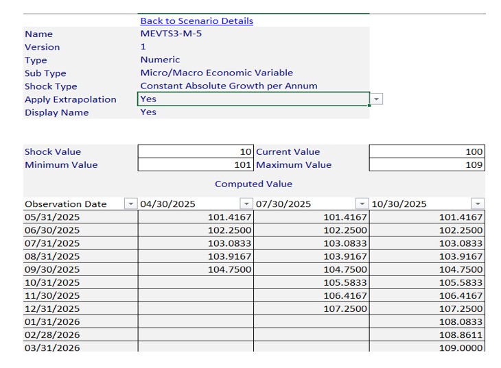

- Constant Absolute Growth per Annum:
The formula and other configurations remain unchanged. However, in this case, the values are calculated based on observation dates corresponding to future periods. Minimum and maximum bounds are also applied for time series (TS)-based variables.
For example, if the user provides a current value of 5%, the calculation for the first future date (for example, 03/06/2025) will be based on the observation period from 30/04/2025 to 31/05/2025.
For the next future date (03/07/2025), the value from 03/06/2025 will be carried forward through interpolation, which, in this case, remains unchanged. As a result, the values across all future dates remain consistent, as shown in the scenario grid.
Figure 6-2 Constant Absolute Growth per Annum

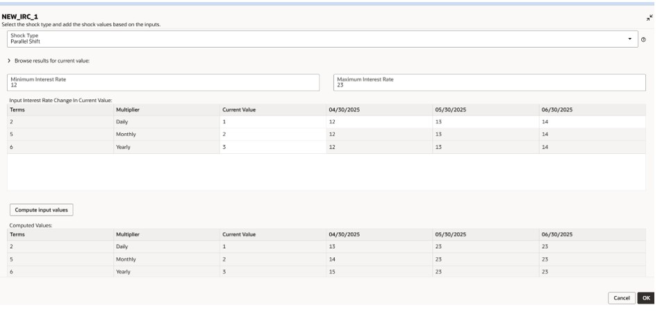

- Parallel Shift: the formula to claculate this is as
follows:
Figure 6-7 Parallel Shift formula
The user may optionally specify minimum and maximum bound values.
A single delta value is entered for all future dates and is uniformly applied to the current values.
This results in a parallel shift of the entire curve.
