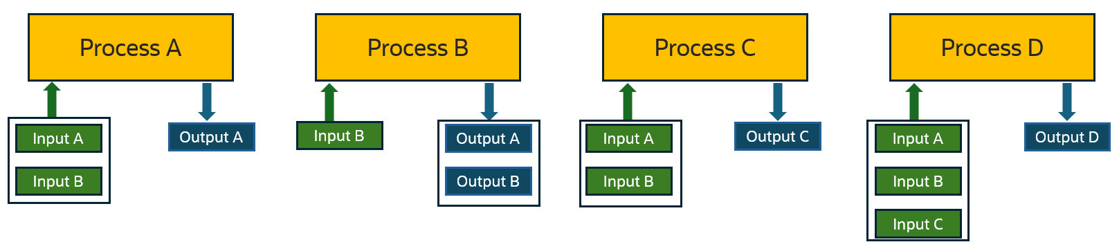

    A glossary term on the data catalog has an input and output sub-glossary term. These sub-glossary terms are tagged to processes and models.
    For example, Glossary terms A, B and C have input sub-glossary terms as Input_A, Input_B, Input_C and Output_A, Output_B and Output_C respectively.
    These sub-glossary terms can be tagged to processes and models on the data catalog.
    Assuming input_A is tagged to process A, process C and process D and
    output_A is tagged to process B.
    Input_B is tagged to process C, and output_B is tagged to process B.
    Input_C is tagged to process A and process D and output_C is tagged to process C.
    Input_D is tagged to proceed D and output_D is tagged to process A.
    This is represented in the below image.
    Figure 6-8 Glossary terms example

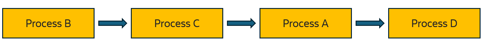

    Then, the processes are sequenced as below:
    First process B is executed and then process C is executed followed by process A and finally process D is executed. The auto-sequencing is in this particular order since process B is not dependent on any inputs (or process) and can start immediately. However, process C has a dependency on process B (since the output of process B is an input to process C). Similarly, process A cannot run independently as it requires inputs from process C and process A's outputs are an input to process D.
    The sequence of process is as per the below image:
    Figure 6-9 Process sequence example
    Process sequence
