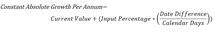

  • Constant Absolute Growth Per Annum (CAGPA) - the formula to calculate this is:
    CAGPA
    Where,
    Current Value - is the reference value entered on the UI
    Input Percentage - is the percentage value of growth or deprecation
    Date Difference - is the frequency selected.

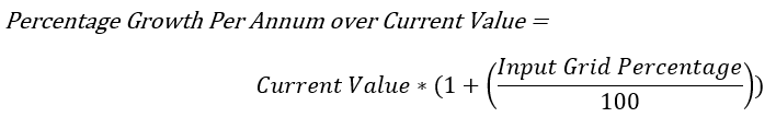

  • Percentage Growth Per Annum over Current Value (PGPAC) - the formula to calculate this is:
    PGPAC
    Where,
    Current Value - is the value entered on the UI.
    Input Grid Percentage - is the percentage you enter by which you want to increase or decrease the current value of reference date.

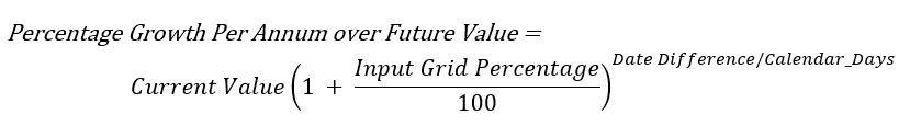

  • Percentage Growth Per Annum over Future value (PGPAF) - the formula to calculate this is:
    PGFAF
    Where,
    *For each iteration the Current Value is updated based on the previous calculation
    Input Grid Percentage - is the change per annum
    Data Difference - is the difference between the frequency of dates mentioned

For Constant absolute growth per annum shock type, the calculations are as follows:
  1. The start date is displayed as part of the first sequence that is 31/May/2024 and the next date is calculated based on the frequency type (in this case, monthly or 30 days difference). Hence, the next date is 30/June/2024.
  2. In this case, you can define the Absolute value or Constant Absolute Value(FOR ALL DATES) percentage as 50% and the Current Value as 10.
  3. When you click Compute input values, then the absolute growth for 31st May and 30th June are 11.3889 and 15.5556.
    Since,
    • DDC1: Date Difference From Current Value (D1-D0)=10
      DDC2: Date Difference From Current Value(D2-D0)=40
    • Constant Absolute Growth Per Annum on 31/May/2024 (11.3889) = 10 +(50*(10/360))
    • Constant Absolute Growth Per Annum on 30/June/2024 (15.5556) = 10+(50*(40/360))

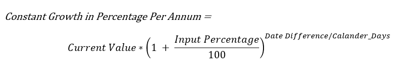

For Constant growth in percentage per annum shock type, the calculations are as follows:
  2. In this case, you can define the percentage or the Constant Percentage Value as 50% and current value as 10.
  3. When you click Compute input values, then the growth rate on 31st May and 30th June are 10.1133 and 10.4608.
    Since,
    • Constant growth in percentage per annum on 31/May/2024 (10.1133) = 10*(1+(50/100))(10/360)
    • Constant growth in percentage per annum on 30/June/2024 (10.4608) = 10*(1+(50/100))(40/360)

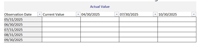

  • Absolute Values: Users manually input absolute values in the scenario grid.
    Figure 6-1 MVETS Absolute Values

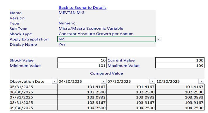

  • Constant Absolute Growth per Annum:
    The formula and other configurations remain unchanged. However, in this case, the values are calculated based on observation dates corresponding to future periods. Minimum and maximum bounds are also applied for time series (TS)-based variables.
    For example, if the user provides a current value of 5%, the calculation for the first future date (for example, 03/06/2025) will be based on the observation period from 30/04/2025 to 31/05/2025.
    For the next future date (03/07/2025), the value from 03/06/2025 will be carried forward through interpolation, which, in this case, remains unchanged. As a result, the values across all future dates remain consistent, as shown in the scenario grid.
    Figure 6-2 Constant Absolute Growth per Annum

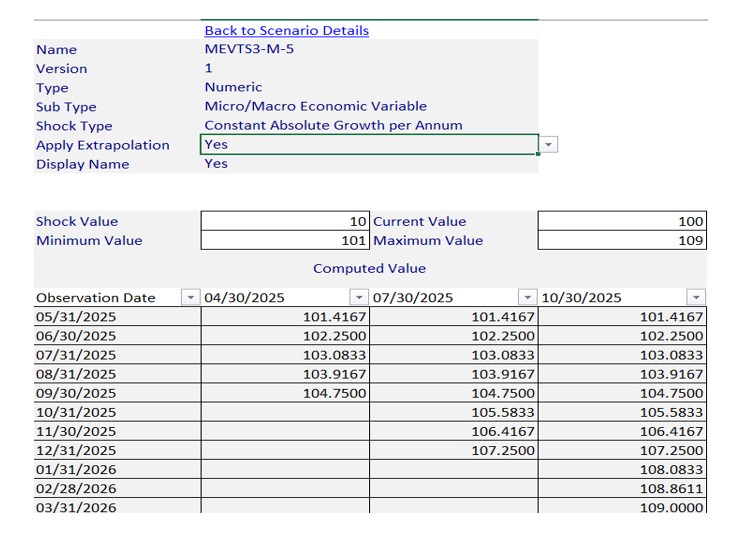

    Extrapolation Support
    Users can enable extrapolation to extend observation dates beyond the current timeframe.
    • A new grid appears with extended future dates.
    • The number of extra dates depends on the frequencies of the scenario and the variable.
    Frequency Base Days:
    • Yearly (Y): 360 days
    • Quarterly (Q): 90 days
    • Monthly (M): 30 days
    • Weekly (W): 7 days
    • Daily (D): 1 day
    The formula to calculate this is:
    Figure 6-3 MVETS Variable formula
    Example:
    If the scenario frequency is Quarterly (90 days) and the variable frequency is Monthly (30 days):
    Q/M = 90/30 = 3, therefore, 3 new dates are added per extrapolation step.
    Extrapolated values are calculated using the same formula as defined for the selected shock type.
    Figure 6-4 MVETS Variable Example
  • Constant Growth in Percentage per Annum:
    This type follows the same rules as the Constant Absolute Growth per Annum shock type, but uses a percentage-based growth formula.

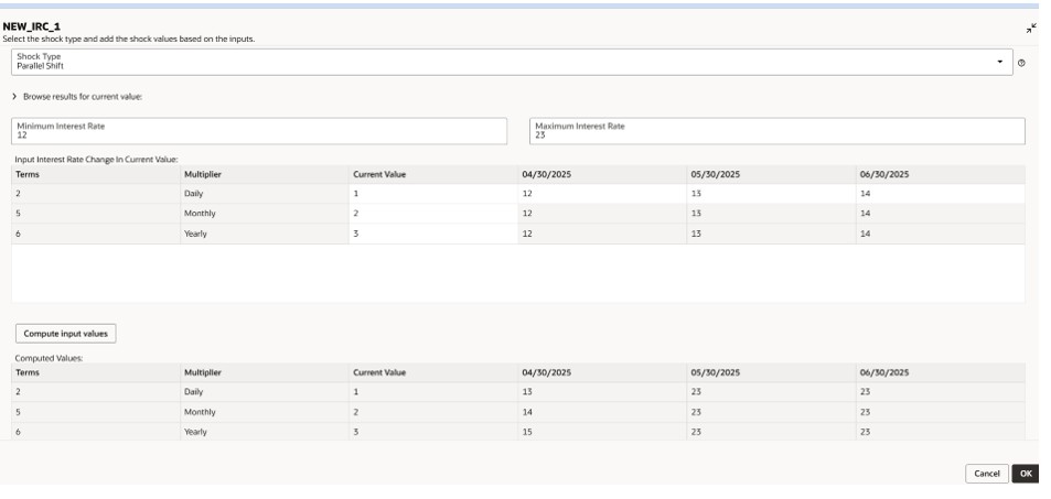

Shock Types for IRC Variables
If you have selected numeric type of variable select from one of the shock type and provide your inputs.
  • Absolute Value - the formula to calculate this is:
    Absolute Value
    Where,
    Input Value is the value entered on the User Interface (UI).
  • IRC Variable Grid Formation
    During the variable creation process, terms and multipliers are defined for the IRC variable.
    Users can then enter current values, and the system will calculate corresponding future date values.
    The resulting grid appears as follows:
    Figure 6-5 IRC Variable Grid Formation

  • Parallel Shift: the formula to claculate this is as follows:
    Figure 6-7 Parallel Shift formula
    The user may optionally specify minimum and maximum bound values.
    A single delta value is entered for all future dates and is uniformly applied to the current values.
    This results in a parallel shift of the entire curve.
