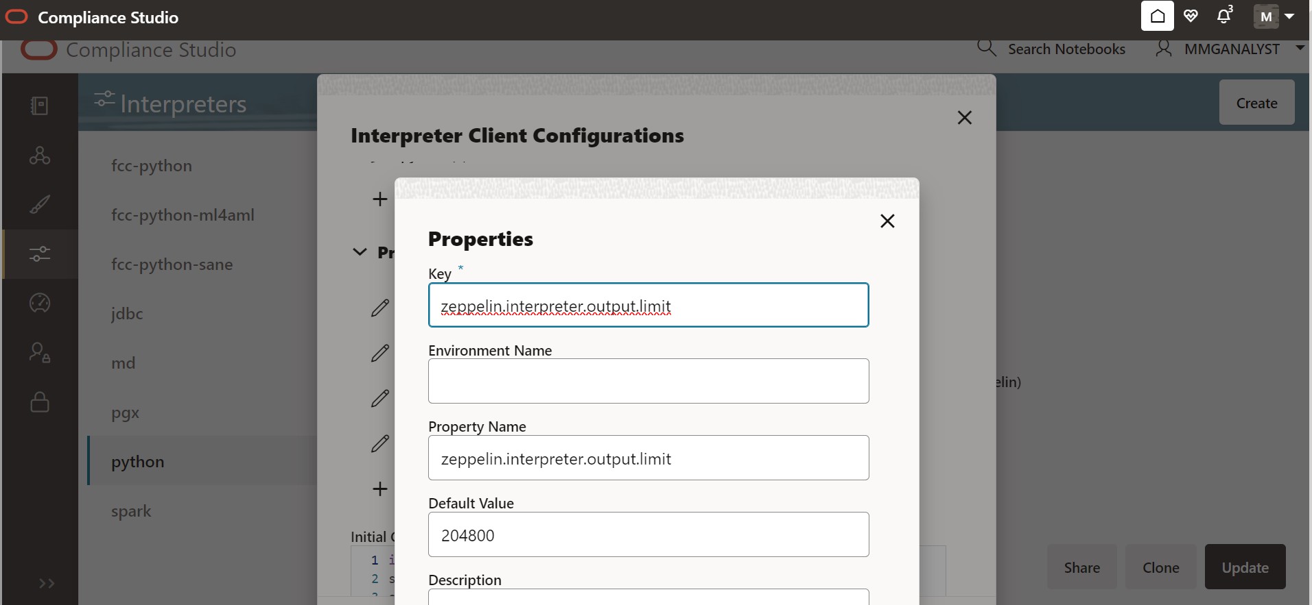

  8. Under Properties, click on +Properties. The Properties popup is displayed.
  9. Fill the options as shown in the following spring-postSacalert.properties file figure . Set the default value to 870400 (for 1000 records approx.).

    Figure L-1 spring-postSacalert.properties file
