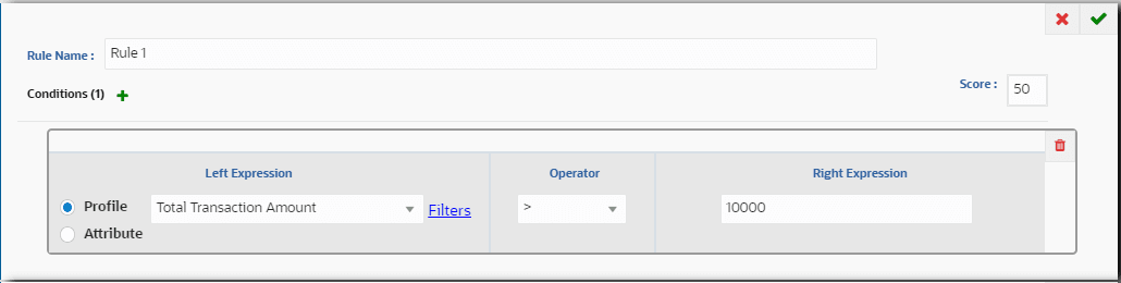

- Define a rule (Rule 1) with the score 50 based on the following conditions:
- Conditions: When Total Transaction Amount > 10000
- Result: Event 1 and Event 2 will be assigned a score as 50

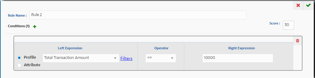

- Define a rule (Rule 2) with the score 30 based on the following conditions:
- Conditions: Total Transaction Amount < = 10000
- Result: Event 3 will be assigned a score as 30

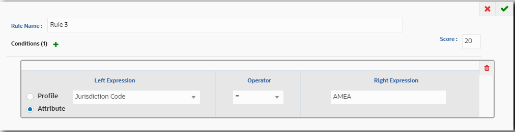

- Define a rule (Rule 3) with the score 20 based on the following conditions:
- Conditions: Jurisdiction code = AMEA
- Result: Event 1 will be assigned a score as 20
Follow these steps to define this use case:
- Add a rule (Rule1) using Add
from the Rules window. The Rules window is displayed.
- Enter the Rule Name and Score as 50.
- Define the Condition 1 as Total Transaction Amount >10000
Figure 6-3 Example of Event Scoring – Rule 1
- Click Save
- Add a rule (Rule 2) using Add
- Enter the Rule Name and Score as 30.
- Define Condition 1 as Total Transaction Amount < = 10000.
Figure 6-4 Example of Event Scoring – Rule 2
- Click Save
- Add a rule (Rule 3) using Add
- Enter the Rule Name and Score as 20.
- Define the Condition 1 as Jurisdiction code = AMEA.
Figure 6-5 Example of Event Scoring – Rule 3
- Click Save
