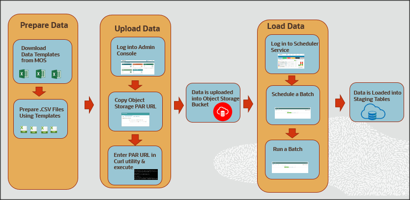

The primary job of a Data Administrator is to prepare, upload, and load data into the application staging tables.
The following illustration provides the workflow of the OFS FCCM Cloud Service Data Loading Service.
Figure 1-1 Data Loading Workflow
This figure shows how Administrators prepare, upload, and load data into the application. This workflow is explained in detail below.
As a Data Administrator, you must download specified data templates from the My Oracle Support page and then export the bank's data into specified templates in the .csv format using the ETL process every day. If the .csv file is bigger than 100MiB, it is recommended to split them into two or more files for swift upload. For example, < filename>_1 .csv, < filename>_2.csv, < filename>_3.csv, and so on. This helps to load data swiftly into the application staging tables.
  1. Log in to Admin Console and go to the Object Storage Standard pane.
  2. Copy the Object Storage Standard bucket Pre-authenticated (PAR) URL.
  3. Open an HTTP utility such as cURL and enter the data file path, PAR URL, and name of the .csv file and then execute it. Data is uploaded into the Object Storage Standard bucket.
After the successful upload of data, a message is displayed as < HTTP/1.1 200 OK> in the cURL utility.
The Object Storage Standard bucket stores data for seven days. After seven days, data is auto-archived in the Object Storage Archive Bucket.
The PAR URL is refreshed daily.
To process data files from the Object Storage Standard Bucket to the staging tables, log in to Scheduler Service, go to Schedule Batch, and then select the AMLDataloading batch. Run the batch based on the requirement, for example, daily, weekly, and so on. Business data is loaded into the application staging tables successfully.
