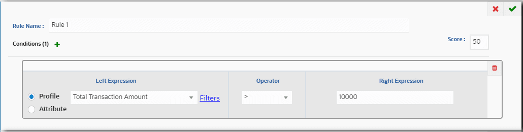

  1. Define a rule (Rule 1) with the score 50 based on the following conditions:
    • Conditions: When Total Transaction Amount > 10000
    • Result: Event 1 and Event 2 will be assigned a score as 50

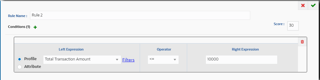

  2. Define a rule (Rule 2) with the score 30 based on the following conditions:
    • Conditions: Total Transaction Amount < = 10000
    • Result: Event 3 will be assigned a score as 30

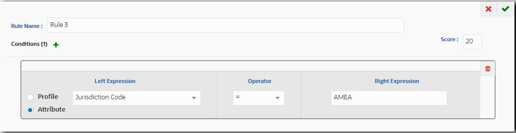

  3. Define a rule (Rule 3) with the score 20 based on the following conditions:
    • Conditions: Jurisdiction code = AMEA
    • Result: Event 1 will be assigned a score as 20

  1. Add a rule (Rule1) using Add Add icon from the Rules window. The Rules window is displayed.
    1. Enter the Rule Name and Score as 50.
    2. Define the Condition 1 as Total Transaction Amount >10000
      Figure 6-3 Example of Event Scoring – Rule 1
      This image shows the Rules window for Rule 1 with the conditions displaying as described in the steps.
    3. Click Save Save icon.
  2. Add a rule (Rule 2) using Add Add icon from the Rules window. The Rules window is displayed.
    1. Enter the Rule Name and Score as 30.
    2. Define Condition 1 as Total Transaction Amount < = 10000.
      Figure 6-4 Example of Event Scoring – Rule 2
      This image shows the Rules window for Rule 2 with the conditions displaying as described in the steps
  3. Add a rule (Rule 3) using Add Add icon from the Rules window. The Rules window is displayed.
    1. Enter the Rule Name and Score as 20.
    2. Define the Condition 1 as Jurisdiction code = AMEA.
      Figure 6-5 Example of Event Scoring – Rule 3
      This image shows the Rules window for Rule 3 with the conditions displaying as described in the steps
