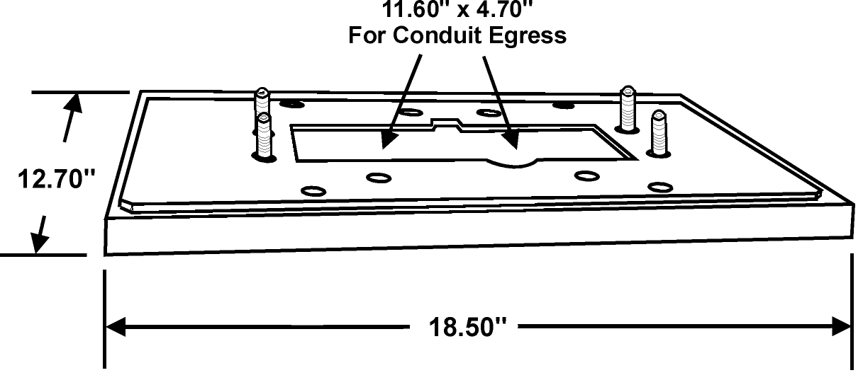

Concrete Slab
A 0.23” (6mm) thick base plate is affixed to the pedestal to provide a stable platform. Mount the base plate to a 1/2” thick concrete slab, roughly the same dimension as the base plate. An opening for conduit egress is located at the center of the base plate.
For new installations, a minimum of four studs (supplied by the installer) projecting from the slab is required.
Figure 18-2 Pedestal Slab Example

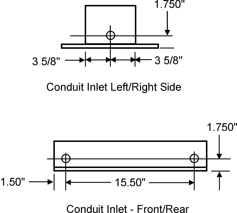

Alternately, the conduits can enter the pedestal from outside the enclosure. The figure below displays the locations of the 1” OD conduit punch-outs – on the front, back, and sides of the pedestal.
Figure 18-3 Pedestal Alternate Conduit Entry Dimensions

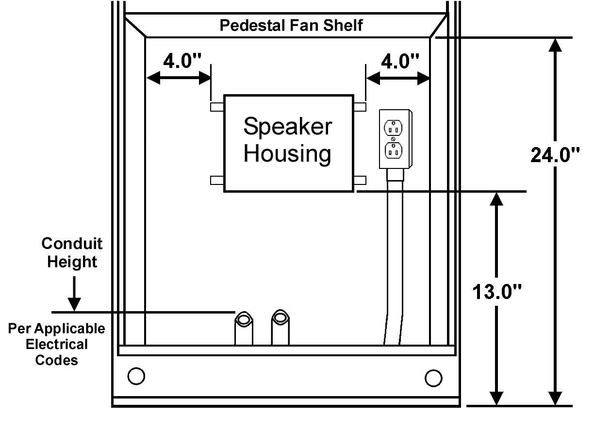

Pedestal AC Outlet
An AC outlet is required within the pedestal housing. The figure below shows the area available in the Pedestal that is used to mount the outlet box. Local electrical codes may require a Ground Fault Interrupter (GFI) outlet to be mounted at least two feet above ground level in areas prone to flooding.
The preferred method is to mount the outlet box directly to conduit, positioned at a height above ground level that meets local electrical codes.
Figure 18-4 Pedestal AC Outlet - Recommended AC Outlet Location
