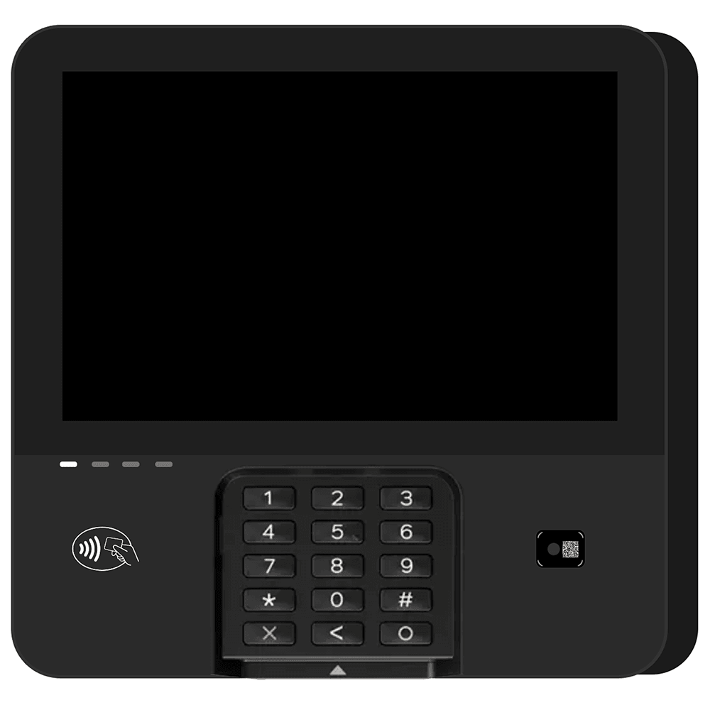

This figure shows the front of the Verifone M450 payment terminal.
