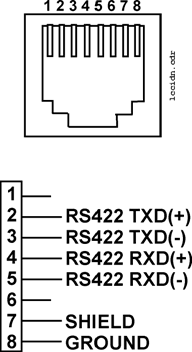

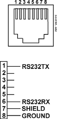

You can configure the IDN connector to run in RS422 mode or RS232 mode as shown in the following table.
Table 11-1 IDN Pin Reference
| RS422 | RS232 |
Figure 11-1 RS422 Mode ![]() |
Figure 11-2 RS232 Mode ![]() |
