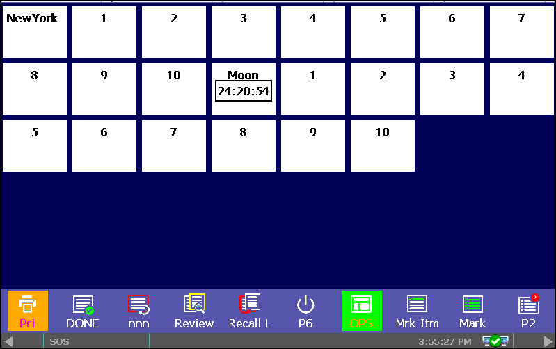

SOS Display
SOS Displays allow managers to continuously monitor the status of all tables in the restaurant. The SOS Display is divided into a grid, with each cell representing a different table. An SOS display is considered an Expo Display; the only difference is the initial grid that displays all the tables. Double-tapping one of the table grids shows that table's check detail information as a chit image of the Expo check.
Figure 3-6 SOS Display
The cells change color to reflect the table status as guests are seated and orders are processed through the system:
Table 3-5 SOS Display Table Color Coding System
| Cell Color | Table Status |
Gray |
The table is empty. |
White, with no timer |
A check has started for the table, but no active order is in the kitchen. |
White, with a timer |
A check has started and an appetizer (course 1) is on the active order chit that shows in the kitchen. |
White, the timer appears within a box |
A check has started and there is no appetizer (course 1) on the active order chit that shows in the kitchen. |
Yellow |
The order chit has passed the first predefined time limit (configured in Order Devices). |
Red |
The order chit has passed the second predefined time limit (configured in Order Devices). |
Blue |
The entree course (course 2) has been served and the only remaining course is dessert. |
