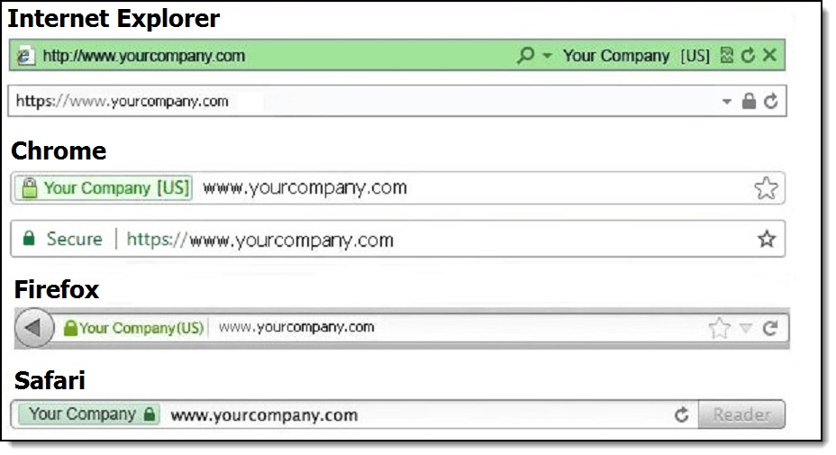

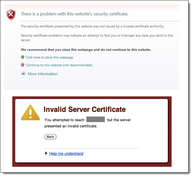

  3. If a Lock symbol is displayed in the address bar, the client has been successfully validated. The Lock symbol and parts of the URL address bar may be green or grey. If an X, red symbol, or error appears, the client has not been validated. Immediately take steps to remedy the issue by contacting the appropriate representative within your organization, or contact your Oracle support representative to begin the remediation process.
    The location and appearance of the symbol vary based on the web browser.

    Figure 6-1 Valid Certificate Examples by Browser
    This figure shows examples of valid certificates based on the browser that you are using.
    Figure 6-2 Invalid Certificate Example
    This figure shows an example of an invalid server certificate.
