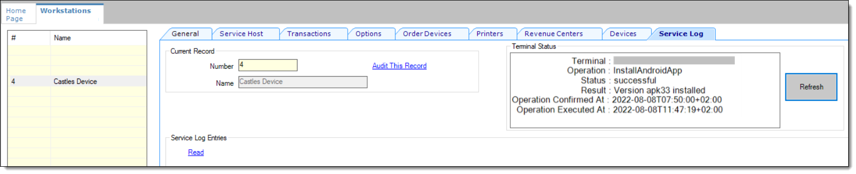

After successfully installing a Castles S1F2 device, you can check the installation status of the device’s Simphony POS Android Package (APK) at any time by performing the following steps:
  1. Select the property, click Setup, and then click Workstations.
  2. Find the Castles device you want to check (search by Workstation ID), and double-click the record.
  3. Click the Service Log tab and review the log entry in the Terminal Status window. You can update the Terminal Status information by clicking the Refresh button.
    Figure 12-14 Workstations Service Log Tab
    This figure shows the Workstations module Service Log tab and its contents.
