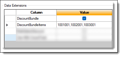

  1. Navigate to proper hierarchy node in the locations tree, click Configuration, and then click [under Sales] Discounts.
  2. Double-click on the desired discount and switch to form view.
  3. From the Data Extensions tab, select DiscountBundle.
  4. Configure DiscountBundleItems as a comma-separated list of menu item object numbers for the menu items to be added to the check before the discount is applied.
    Figure 15-10 Data Extensions
    This figure shows the discount bundle data extensions tab.
  5. Save your changes.
