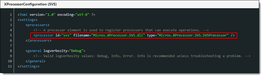

  3. Locate the processor id=”svs” entry. This file includes an entry for the SVS Processor as shown in the following figure:
    Figure 41-8 XProcessor Configuration Entry for SVS
    This figure shows the XProcessor Configuration processor id entry for the SVS Processor, indicated with a red rectangle surrounding the code.
    If you are using only the SVS Processor for the gift card service, un-comment the SVS Processor and delete or keep the existing comment marks around the other processors.

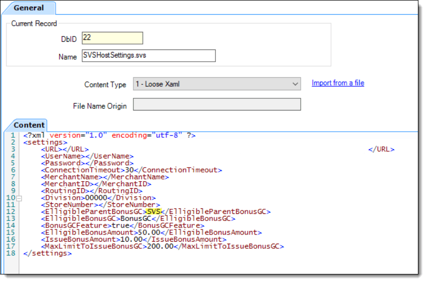

  10. Add the SVSHostSettings.svs configuration file to the Content module.
    This file needs to be modified to set various connection settings to the SVS host and to enable the optional Bonus Gift Card feature. Entries here also set the bonus gift card’s amount values.
    1. Import the SVSHostSettings.svs.xml file available in the [Drive Letter]:\MICROS\Simphony2\EMCClient folder.
    2. Modify this configuration file for rows 3 through 11 to match the information provided by your SVS service provider.
      Figure 41-10 EMC Content Module - Imported SVSHostSettings.svs File
      This figure shows the EMC Content module and the SVSHostSettings.svs configuration settings.
    3. To enable the Bonus Gift Card feature, configure rows 12 through 17:
      Bonus Card configuration is required even if users have no intention of using the Bonus Card feature. As described in step 11 (below), the SVSBonusCard.svs XML file must be added to the Content module and the file needs to have its placeholder values replaced with valid record numbers (even if they are not referring to actual service charge or discount entries). Add valid service charge and discount record numbers to the placeholder fields as shown in this figure: EMC Content Module - Imported SVSBonusCard.svs File.

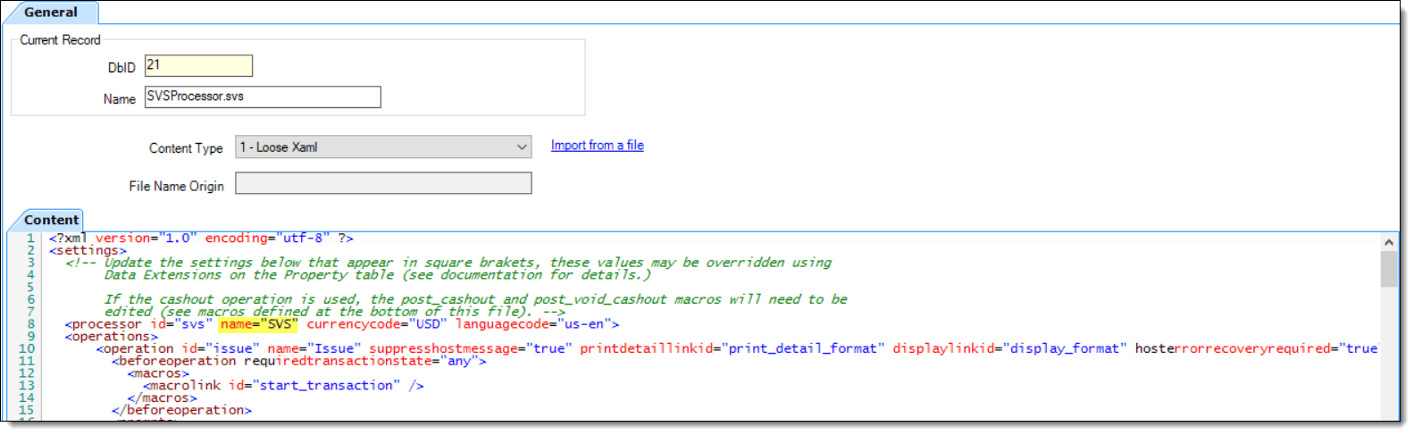

      • ElligibleParentBonusGC: This field is user defined, but must match the name field of the parent processor as configured in the SVSProcessor.svs file (shown below).
        Figure 41-11 EMC Content Module - Imported SVSProcessor.svs File
        This figure shows the EMC Content module and the SVSProcessor.svs configuration settings.

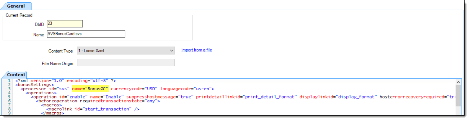

      • ElligibleBonusGC: This field is user defined, but must match the name field located in the SVSBonusCard.svs (shown below).
        Figure 41-12 EMC Content Module - Imported SVSProcessor.svs File
      • BonusGCFeature: This field enables the Bonus Gift Card feature by setting it to true. The default setting for this field is false (disabled).
      • ElligibleBonusAmount: This field is for used to establish the amount that customers are eligible for an additional bonus gift card after the ElligibleBonusAmount field’s threshold is reached. In the Figure EMC Content Module - Imported SVSHostSettings.svs File (above), because the eligible bonus amount is set to 50.00, when a customer purchases a 50.00 gift card, they are eligible to receive an additional bonus gift card amount as configured in the subsequent IssueBonusAmount field (this amount is 10.00 as shown in the same figure).
      • IssueBonusAmount: This field establishes the amount of the bonus gift card that is issued when customers meet the configured bonus gift card threshold amount. This amount must match what SVS has configured.
      • MaxLimitToIssueBonusGC: This field establishes the maximum amount customers are eligible for earning additional bonus gift cards. In other words, if this value is set to 200.00, customers are limited to earning four 50.00 gift cards (for a total of 200.00), thus earning four bonus gift cards (worth 10.00 each for a total value of 40.00).

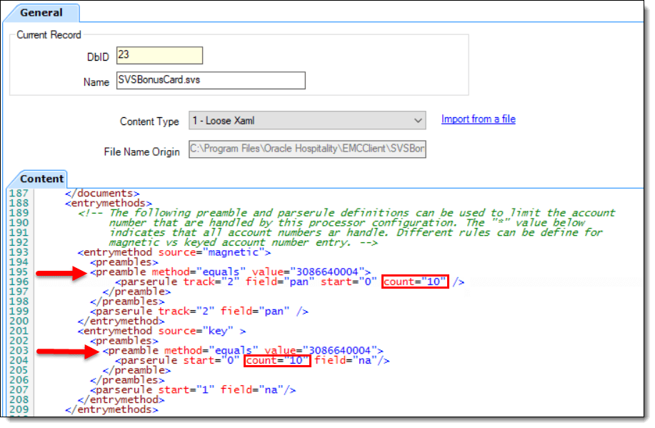

    2. To assist the system with identifying gift cards (for both magnetically swiped and manually entered cards), enter your issued gift cards preamble numbers in the value field. Scroll down to the preamble section (near row 190) and edit the rows beginning with preamble. You must determine how many preamble digits you want to enter. Oracle Restaurants recommends entering a range from 10 to 17 digits.
    3. Enter the number of digits you entered in the value field in the count field. The number of digits entered in the value field must match the number entered in the count field.
      Figure 41-13 EMC Content Module - Imported SVSBonusCard.svs File Preamble Settings
      This figure shows the EMC Content module and the required SVSBonusCard.svs gift card preamble number configuration fields.

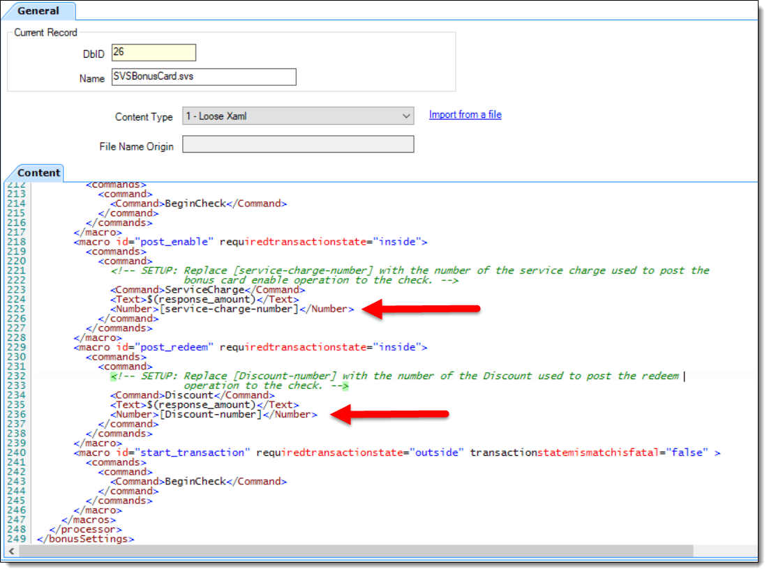

    4. Bonus card transactions are primarily handled based on the assigned discount. Modify the configuration file with the appropriate service charge and discount record numbers between the braces, leaving only the record number between the Number tags.
      Figure 41-14 EMC Content Module - Imported SVSBonusCard.svs File
      This figure shows the EMC Content module and the required SVSBonusCard.svs service charge and discount configuration fields.
