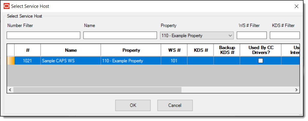

  7. Set the Deployment Type to 2 - Specific Service Host from the drop-down list, and then click the ellipsis ‘’ adjacent to the Deployment Type drop-down list.
  8. Select the Check and Posting Service (CAPS) workstation for your property, and then click OK to close the Select Specific Service Host list. Click OK again to close the CAL package selection window.
    Figure 1-7 CAL Packages Add Deployment for a Specific Service Host for CAPS Workstations
    This figure shows the Select Service Host selection window for CAPS workstations.
