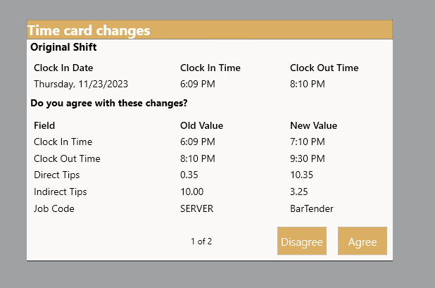

  2. If the manager or payroll team changed the following information on your time card, the Time Card Changes dialog appears.
    • Clock In Date
    • Clock In Time
    • Clock Out Time
    • Direct Tips
    • Indirect Tips
    • Job Code
    If more than one adjustment is made to a time card, only the original and current changes appear in the Time Card Changes dialog. After acknowledging the current notification (the following figure shows 1 of 2), the next time card adjustment appears (2 of 2), and so on until all time card changes have been acknowledged.
    Acknowledge the time card change by clicking Agree or Disagree.
    Figure 2-1 Time Card Changes Dialog
    This figure shows the Time Card Changes dialog, when changes have been made to the time card. The employee must acknowledge the changes.

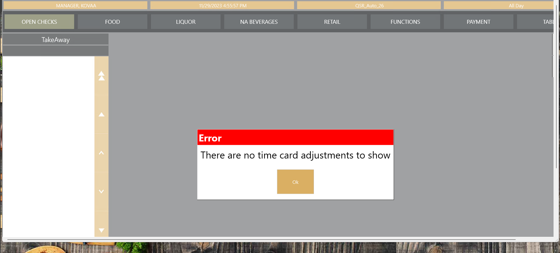

  3. To check for time card adjustments on demand during your shift (after clock in and sign in but before clock out), click the Time Card Adjustment Notification button (if configured). If the time card has not been adjusted, the following message appears.
    Figure 2-2 On Demand With No Time Card Adjustments
    This figure shows the time card adjustment message after clicking Time Card Adjustment Notification, when no changes have been made to the time card.
