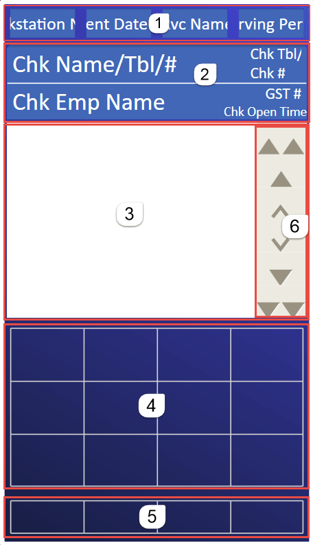

HHT Full Width Check Detail and Simple Button Grid
The width settings for all areas in this template default to 272 and cannot be changed.

This figure shows the HHT Full Width Check Detail and Simple Button Grid template that appears in the EMC's Page Design Module.
The following table describes the areas called out in the image.
Table 26-10 HHT Full Width Check Detail and Simple Button Grid
Callout Number Area Description
1
Status Bar
The default height is 30 and can be changed. Increasing or decreasing the height affects the height of the large content area. You can remove this area from the template.
Elements:
  • Workstation Name
  • Current Date/Time
  • RVC Name
  • Serving Period
2
Check Detail Header
This appears with the Check Detail area and shows the following information:
  • Check Name/Number or Table
  • Order Type
  • Employee Name
  • Number of Guests
  • Time check was opened
  • Order Channel (if configured)
3
Check Detail
The default height is 250 and can be changed. Increasing or decreasing the height affects the height of the large content area. You can remove this area from the template.
4
Large Content Area
You can change the size of this area by making the other areas larger or smaller. The grid defaults to 4 columns and 3 rows, but you can change it.
5
Bottom Content Area
The default height is 40 and can be changed. Increasing or decreasing the height affects the height of the large content area. You can remove this area from the template. The grid defaults to 4 columns and 1 row, but you can change it.
6
Scroll Bar
This does not appear on the POS handheld device. The check detail is scrollable using gestures.

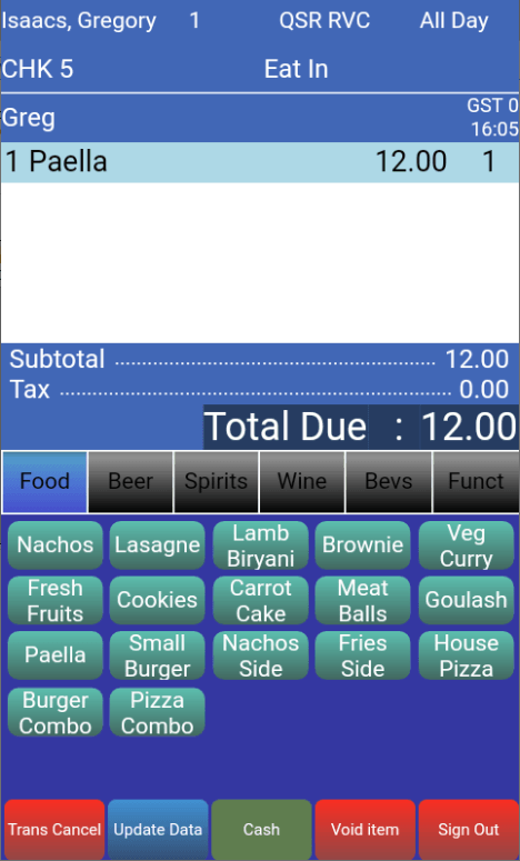

The following figure shows an example of the HHT full width check detail and simple button grid template as it appears on the POS handheld device.
Figure 26-12 Full Width Check Detail and Simple Button Grid on POS
This figure shows the HHT Full Width Check Detail and Simple Button Grid template as it appears on a POS handheld device.

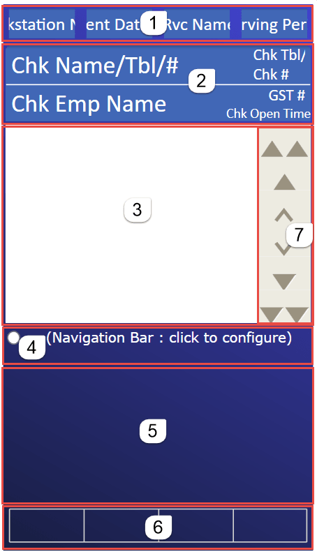

HHT Full Width Check Detail and Tabbed Button Grid
The width settings for all areas in this template cannot be changed. The width settings for most areas in this template default to 272, except for the navigation bar, which is 268.

This figure shows the HHT Full Width Check Detail and Tabbed Button Grid template that appears in the EMC's Page Design Module.
Table 26-11 HHT Full Width Check Detail and Tabbed Button Grid
1
Status Bar
Elements:
  • Workstation Name
  • Current Date/Time
  • RVC Name
  • Serving Period
2
Check Detail Header
  • Order Type
  • Employee Name
  • Number of Guests
3
Check Detail
4
Navigation Bar
5
Large Content Area
6
Bottom Content Area
7
Scroll Bar

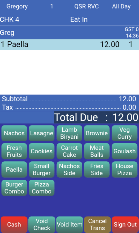

The following figure shows an example of the HHT full width check detail and tabbed button grid template as it appears on the POS handheld device.
Figure 26-14 Full Width Check Detail and Tabbed Button Grid on POS
This figure shows the HHT Full Width Check Detail and Tabbed Button Grid template as it appears on a POS handheld device.

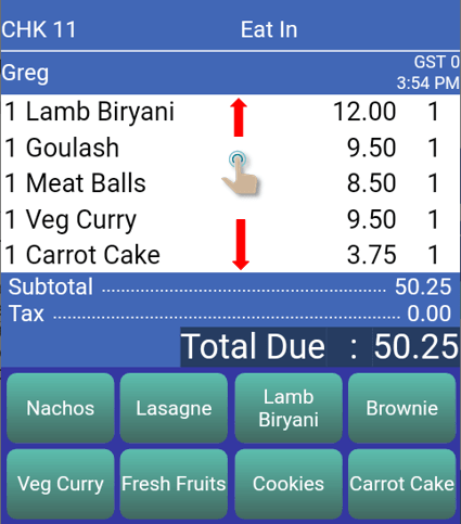

Scrollable Check Detail on POS Device
You can use gestures to scroll the check detail vertically to see other items on the check. The check detail header and footer remain visible while scrolling.
Figure 26-15 Scrollable Check Detail on POS
This figure shows the scrollable check detail on the POS handheld device.
