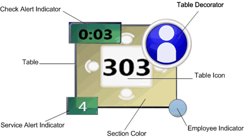

Enhanced Table Status and Functions
Enhanced tables provide graphical images that represent dining statuses and indicators. The following example table illustrates several of the status and indicator icons that might appear on a seated table.
Figure 10-1 Table Status Example
Section Color
Table Decorator
Employee Indicator Color
Open Tables
Occupied Tables
Closed Tables
