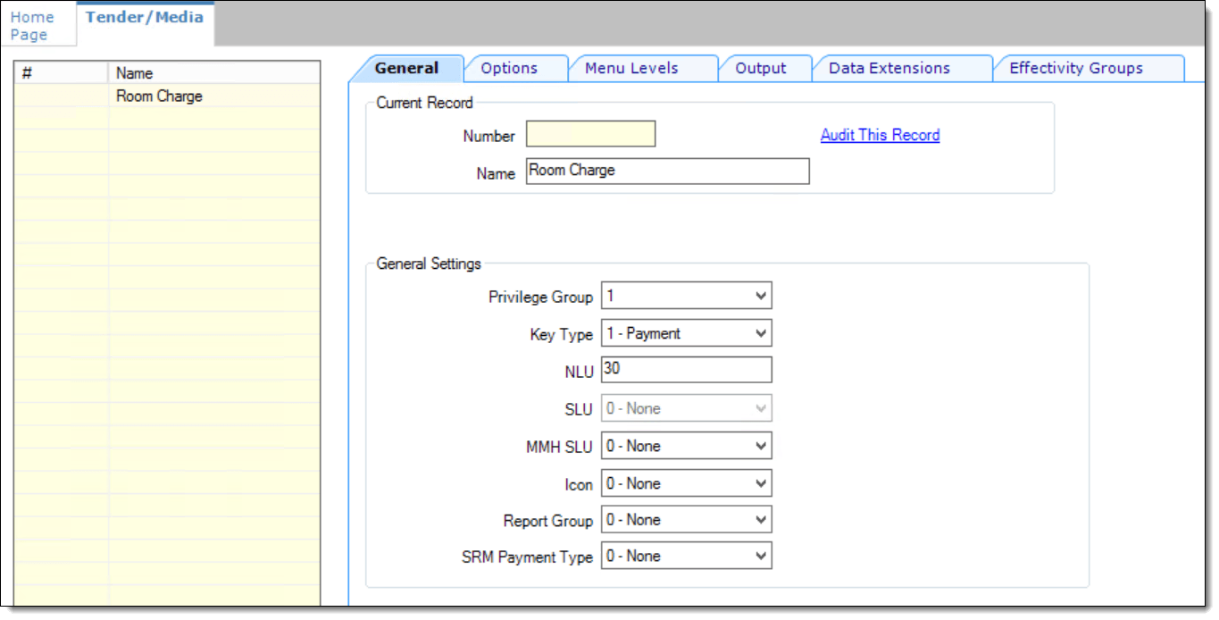

  4. On the General tab, select 1 - Payment from the Key Type drop-down list.
    Figure 43-12 Tender/Media Room Charge Configuration
    This figure shows the Tender/Media module.

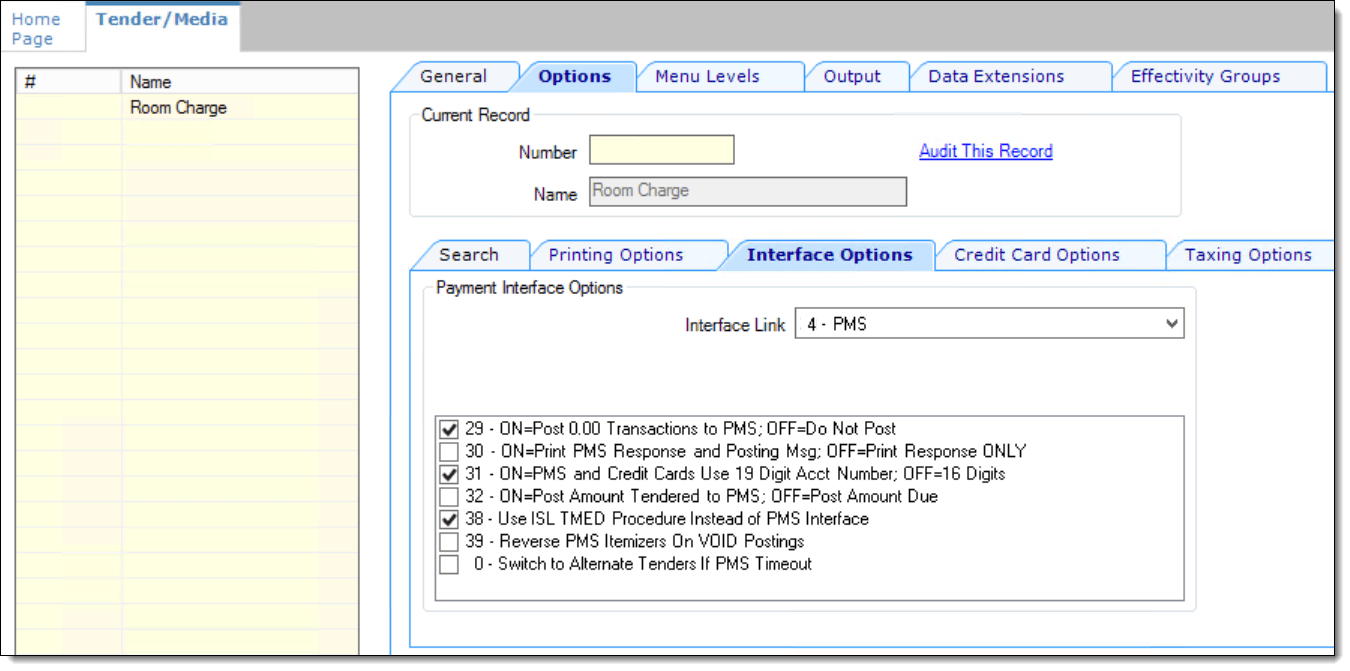

  5. Click the Options tab, and then click the Interface Options subtab.
  6. In the View Interface Names for RVC drop-down list, select the revenue center for which the OPERA PMS interface was assigned, and then select PMS from the Interface Link drop-down list.
    The Interface Link and the View Interface Names for RVC fields are only active if the Tender/Media configuration is being performed at the property level.
    Assign the PMS Interface Link to all payments that must be auto balanced (for example, Cash, Credit Cards, and so on).
  7. Select the following options:
    • 29 - ON=Post 0.00 Transactions to PMS; OFF=Do Not Post
    • 31 - ON=PMS and Credit Cards Use 19 Digit Acct Number; OFF=16 Digits
    • 38 - Use ISL TMED Procedure Instead of PMS Interface
    Figure 43-13 Tender/Media Room Charge Options
    This figure shows the required Tender/Media module’s interface options.
