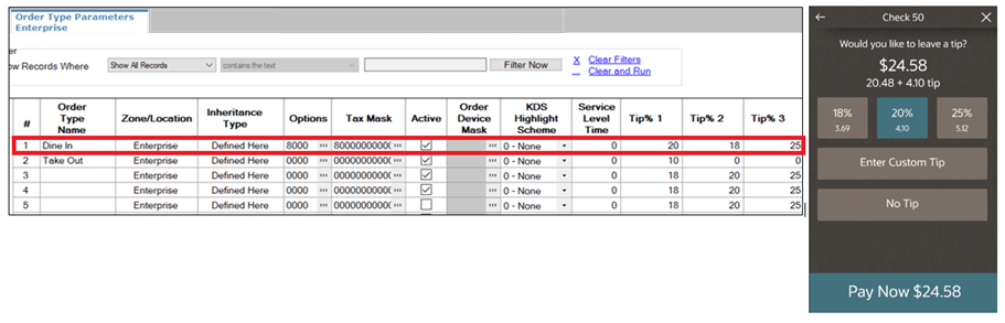

Next, you can configure suggested tip percentages to be used in Guest Pay POS Operations to prompt guests to leave a tip. You can set three suggested tip percentages in the EMC for each order type (Dine In and Take Out). A tip percentage is applied to the check by default. Tip% 1 is applied if more than 0; otherwise Tip% 2 is applied. If both Tip% 1 and Tip% 2 are 0, then Tip% 3 is applied. If all tip percentages are 0 (zero), no tip is applied to the check. The default tip is highlighted in blue in POS Operations. Tip percentages appear in ascending order starting with the lowest entered percentage value. Tips that are 0% are not shown.
The following figure shows an example of tips configured in the EMC, and the corresponding appearance in POS Operations on an Android mobile payment device.
Figure 12-1 Suggested Tip Percentages
This figure shows the Order Type Parameters module with suggested tip percentages indicated in red outline.
You can configure a default order type in the RVC Parameters module. Suggested default tip percentages can be set for each order type parameter. To configure order types, see Configuring Order Types for more information.

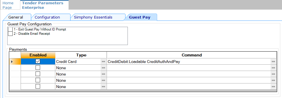

  1. Set the Tender Parameters options and enable a credit card payment:
    1. Select the Enterprise, click Setup, and then click Tender Parameters.
    2. Click the Guest Pay tab.
    3. To ensure that guests cannot exit Guest Pay and start using POS Operations, disable 1 - Exit Guest Pay Without ID Prompt.
      When exiting from Guest Pay, a dialog prompts for an employee ID, ensuring that only restaurant servers can use POS Operations.
    4. To hide the email receipt option, select (check) 2 - Disable Email Receipt.
      If you select option 2, guests will not receive a receipt via email.
      Email receipts must be set up in the Property Parameters module. See Configure Email Receipt Parameters for more information.
    5. In the Payments section, click the ellipsis point (...) button in the Type column, select Credit Card, and then click OK.
    6. Click the ellipsis point (...) button in the Command column, select the following values, and then click OK.
      • Payment Type: Select CreditDebit:Loadable.
      • Functions: Select CreditAuthAndPay.
      The following figure shows an example of the Guest Pay credit card configuration in the EMC Tender Parameters module.
      Figure 12-2 Guest Pay Configuration
      This figure shows the Tender Parameters module, Guest Pay tab and fields.
    7. Click Save.

  4. To configure suggested tip percentages:
    1. Select the Enterprise, property, or revenue center, click Setup, and then click Order Type Parameters.
    2. For each Order Type Name, enter a numerical percent value in the following fields:
      • Tip% 1
      • Tip% 2
      • Tip% 3
    3. Ensure that each order type has Active enabled.
    4. Click Save.
