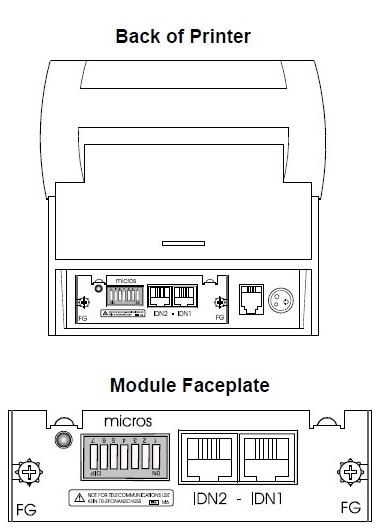

Epson Printer Setup for IDN Module
Set up the module DIP switches as follows:
Table 28-10 Printer ID

Table 28-11 Baud Rate

Figure 28-2 Back of Printer and Module Faceplate
Set the annunciator to OFF by doing the following:
Make sure the printer is off.
Set the switches to the necessary parameters.
Turn the printer on. The Status sheet should subsequently print.
Turn the printer off. Set IDN switches back to their default setting.
