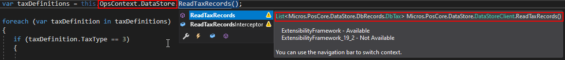

Simphony Extensibility internal DataStoreClient (OpsContext.DataStore) is deprecated and should no longer be used with Simphony 19.2.
The source needs to be updated to make use of the Extensibility DataStoreClient only (namespace Micros.PosCore.Extensibility.DataStore). A sample code is provided below.

DataStoreClient
The following sample is based on a single Visual Studio solution that includes two Simphony Extensibility projects: one built against an earlier Simphony version, and the second built against Simphony 19.2.
Figure 5-1 Deprecated use of Simphony Extensibility Internal DataStoreClient
This figure shows the Deprecated use of Simphony Extensibility internal DataStoreClient.
Figure 5-2 Correct use of Simphony Extensibility DataStoreClient
This figure shows the correct use of Simphony Extensibility DataStoreClient.
