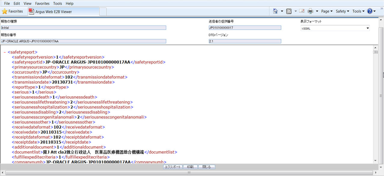

  2. When the system opens the E2B Viewer window, Select SGML from the View Format drop-down list.
    Export an SGML File screen
  3. When the system displays the contents of the SGML file, click Export.
  4. When the system displays the SGML report, click File > Save As.
