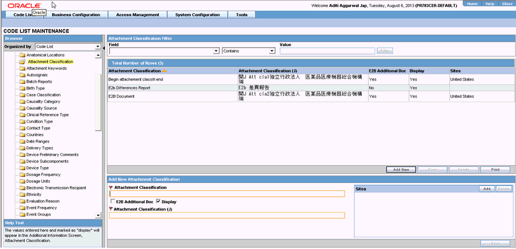

Configure Attachment Classifications
Use the following procedure to configure attachment classifications:
  1. From the Oracle Argus Safety Console, select Code Lists > Argus > Attachment Classification.
  2. When the system opens the Code List Maintenance screen, click Attachment Classification in the Code List in the left pane.
  3. The system places the data for the selected item in the right pane.
    Configure Attachment Classification screen
  4. Click Add New and click the E2B Additional Doc check box in the Add New Attachment Classification section.
  5. Click Save.
