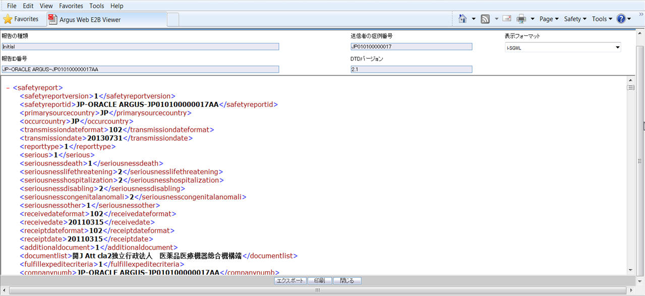

The system enables you to use the following procedure to export an SGML file.
- Click the Final E2B report type on the Regulatory Reports tab.
- When the system opens the E2B Viewer window, Select SGML from the View Format drop-down list.
- When the system displays the contents of the SGML file, click Export.
- When the system displays the SGML report, click File > Save As.
- When the system opens the Save As dialog box:
- Enter a name for the file.
- Browse to the folder where the file is to be saved
- Click Save to save and export the SGML file.
Exporting an E2B report can only be done from the SGML view on final reports. If you select Draft, the Export button becomes unavailable
