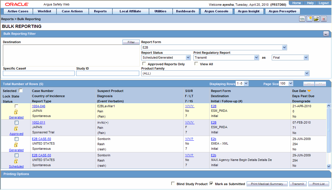

  1. Click Reports > Bulk Reporting.
    Bulk Reporting screen
  2. When the system opens the Bulk Reporting dialog box, enter the appropriate data in the fields.
  3. In the Report Form list, select E2B.
  4. Under Printing Options, select Transmit.
  5. Select the Mark as Submitted check box if it is required to mark the report as "submitted" after the transmission is successful.
  6. Click OK after all the required items in the dialog have been entered. Use the table at the end of this topic to understand the function of each item in the dialog.

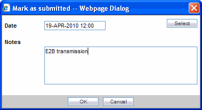

    Mark as submitted pop-up
  9. If the Marked as Submitted check box was selected in step 5, the system opens the Report Submission Information dialog box.
    Enter the submission notes in the Notes field and click OK.
