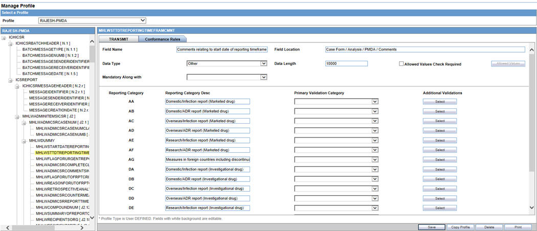

The following is the Conformance tab for PMDA profile:

PMDA-E2B specific fields
| Field | Type | Description |
Reporting Category |
Label |
All Reporting Category (R3) Codes (AA, AB, AC, AD, AE, AF, AG, DA, DB, DC, DD, DE, DF, DG, BC, BD) as configured in the Reporting_category (flex code list) are listed here, along with Nullification. |
Reporting Category Description |
Label |
Description of the corresponding Reporting Category is listed here. |
Primary Validation Category |
Drop-down list |
This drop-down list is available for PMDA profile only. The following option is listed in the drop-down list in the below specified order: Blank (Default) Mandatory Mandatory for Completion Report Conditional Mandatory for Completion Report Conditional Mandatory Do not Enter Other Fatal Validation Optional For PMDA E2B (R3): Refer Mapping xls > Mapping (Sheet) > Reporting Category wise Conformance |
Additional Validations |
Button |
On clicking this button Additional Validation Configuration, the Dialog opens. This Dialog enables users to configure the SQL based validations for the element. Available button available against each Reporting Category. |
Save |
Button |
On clicking the Save button, the changes are committed to Data base and audit logged. This committing of data includes any changes done in the Allowed Value Configuration and Additional Validation Configuration Dialogs as well. On clicking the Save button, the application logic validates that there exists a Primary category for the ICSR Element
If there exists a row with primary category as blank, the application displays an error message: Please select a Primary Validation category for the element, Title: ICSR Validation with OK Button. |
Button |
On clicking the print button, the application prints all the Conformance rule tab data. |
