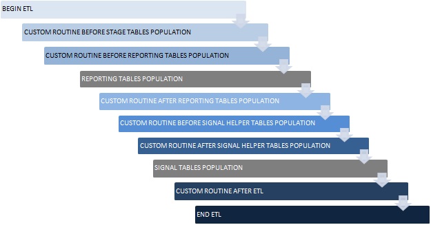

The ETL Hooks can be executed at different staging levels.
  1. Before populating the reporting tables, execute CUSTOM ROUTINE BEFORE STAGE TABLES POPULATION, and/or CUSTOM ROUTINE BEFORE REPORTING TABLES POPULATION.
  2. Before populating the signal tables, execute ETL Hooks CUSTOM ROUTINE AFTER REPORTING TABLES POPULATION, CUSTOM ROUTINE BEFORE SIGNAL HELPER TABLES POPULATION, and/or CUSTOM ROUTINE AFTER SIGNAL HELPER TABLES POPULATION.
  3. After populating reporting and signal tables and before populating the results, execute CUSTOM ROUTINE AFTER ETL.
Figure 1-1 Sequence of ETL Hook Execution
