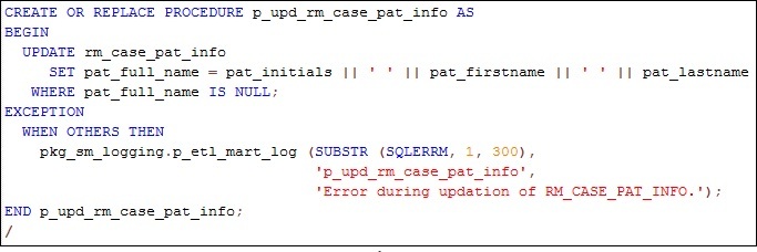

Creating a procedure called P_UPD_RM_CASE_PAT_INFO, to populate a new column called PAT_FULL_NAME in the table RM_CASE_PAT_INFO. The value of this column is calculated, and populated from the existing columns of RM_CASE_PAT_INFO. Here, we concatenate three columns PAT_INITIALS, PAT_FIRSTNAME, and PAT_LASTNAME to populate this value as PAT_FULL_NAME.

    Figure 1-5 Create Custom Procedure
    SQL to Create Custom Procedure
  4. Once this procedure is created, call this procedure using ETL Hook PRE_REPORTING_TABLES_POPULATION.
    The ETL Hook will populate this new column PAT_FULL_NAME in SDLP_CASE_PAT_INFO.
