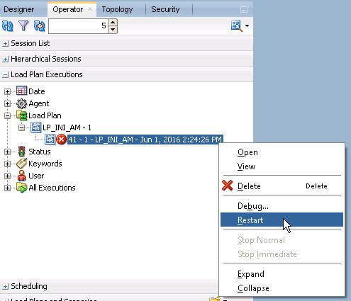

  1. In Load Plan Executions section, Load Plan folder, right-click the Load Plan, which you want to restart.
    The drop-down menu appears.
    Figure 7-3 Restarting the Initial ETL
    Drop-down menu to restarting the Initial ETL
  2. Click Restart.
    The Restart Load Plan dialog box appears.

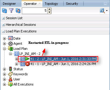

    Another Load Plan is added with the same name as that of the stopped ETL, in the Load Plan folder. However, this instance of the ETL Process appears in green color, which signifies that the ETL is in progress.
    Figure 7-4 Restarted Load Plan
    Status icon of Restarted Load Plan

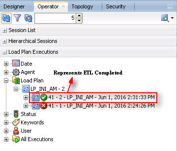

    Once the ETL process is complete, the Load Plan is appear in green color with a check mark.
    Figure 7-5 Completed Load Plan
    Status icon of Completed Load Plan
