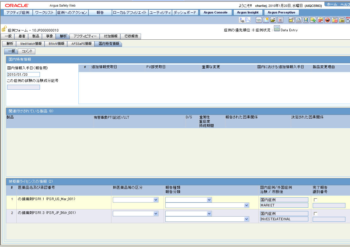

PMDA Information: General Tab
The following figure depicts the General sub-tab of the PMDA Information tab:

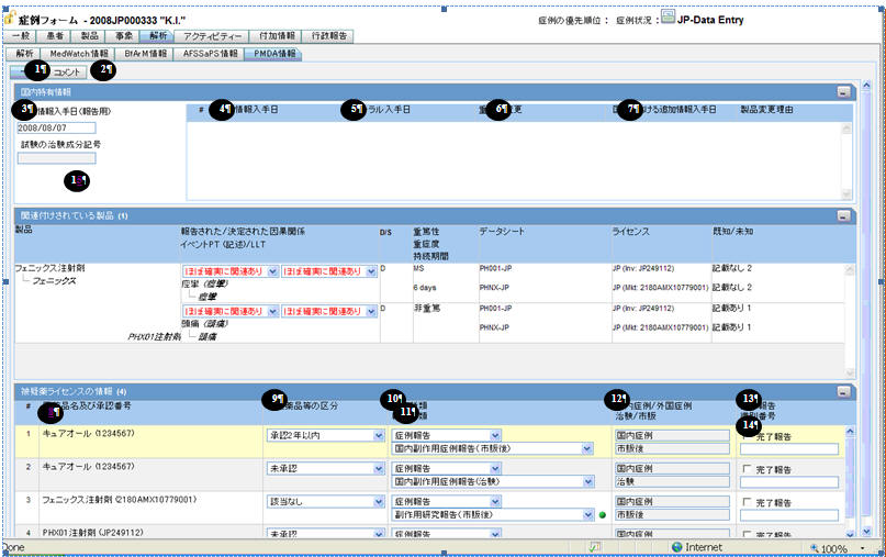

The following table lists the fields in the General tab:
Table 1-1 Fields in the General tab
| # | Field Name | Description |
1 |
General |
This represents the name of the sub-tab under PMDA tab. |
2 |
Comment |
3 |
Japan first information Received Date (For Reporting) |
This field represents the editable text box which displays the date the case was received by the Japanese pharma company (initial receipt date captured during case book-in). The format is YYYYMMDD. In case of a local case, this date represents the Case Initial Receipt date. In global case, this date is automatically populated by the date first opened by J user. The value is stored in the case when you perform direct/indirect Save. For example, accept from worklist stores the value indirectly. |
4 |
Follow-up received date |
This field represents the non-editable text box which displays the date the case follow-up information was received by the pharma company. If the follow-up is marked significant, the Japan Follow-up Received date is used as the reference date to schedule the reports. The format is YYYYMMDD. |
5 |
Safety received date / or Central received date |
This field represents the non-editable text box which displays the date the Safety group received the case. The format is YYYYMMDD. |
6 |
Significant Changes |
This is a non-editable check box to indicate whether the follow-up is significant or not. If the follow-up is significant, the Japan Follow-up date overrides the date used for report scheduling. |
7 |
Japan follow-up received date |
This field represents the editable text box which displays the date the case follow-up information is received by the pharma company. If the case is originated in some country other than Japan, this date represents the date first opened by the J user after the follow-up. If the follow-up is marked significant, the Japan follow-up received date is used as the reference date to schedule the reports. The format is YYYYMMDD.The time stamp of Case Open date done by first Japanese user after the latest foreign follow-up is automatically populated.The value is stored in the case when you perform direct/indirect Save. For example, accept from worklist stores the value indirectly. |
8 |
Drug name and license number |
The number of rows in this section is equal to the number of reports that need to be submitted to PMDA for this case. One report is scheduled for each of the Marketed License. One report each is scheduled for each Study License. The field is read only and show concatenation of Trade Name with License Number in brackets. |
9 |
New Drug Category |
This field represents the drop-down to select License Category LM to select value for E2B J.8 item. |
10 |
Japan Reporting type (OBSOLETE) |
This field indicates the Reporting Type. It is a drop-down list showing three possible values: Case Reporting, Research Reporting, and Action Taken. Note: This dropdown is no longer available. However, as per the standard approach, the existing database column along with existing value are retained as is, the text "OBSOLETE" is added at the beginning of the DB column comments (for both upgraded and fresh schema). The database column is marked as deprecated during the upgrade script. |
11 |
Japan Reporting category |
This field represents a drop-down List containing Reporting Category LM. This is a mandatory field for Argus J user. The selection of this field determines the report being created (ADR, Infection, Research, or Measures in foreign countries). The entries shown in this list are determined at run time by the values selected in items 9,10 and 12.When Reporting Category is not selected, the license does not create the report. The format of the value displayed in this drop-down is: [Reporting Category] - [Description] |
12 |
Domestic Case / Foreign CaseClinical / Marketed |
There are two fields which are non-editable text boxes. The first shows whether the case is foreign (if the country of incidence is not equal to Japan) or domestic (if the country of incidence is Japan).The second field shows the license type: Investigational, if the license on which the ICSR is based on is for an investigational drug, device, or vaccine. Marketed, if the license on which the ICSR is based on is for a marketed drug. |
13 |
Completion Report (Case Complete) |
This check box indicates the completion of the case report. A new Case Complete check box field is added to the License List box. This field is the driver for the E2b field J.6. A separate J.6 must be recorded for each ICSR. By default, this box is not checked. |
14 |
PMDA Identification Number |
The PMDA Number is displayed in the PMDA tab where all the ICSR licenses are displayed. This is the PMDA Acknowledgment Number given in Ack message item B.1.3. This number is used in J.4b from the first follow-up report. |
15 |
Clinical Compound Number in the study of this case |
This field is read only when the study is selected from the Study look up. When the study information is manually entered, Clinical Compound Number is editable. If there is no study information, the field is disabled. |
16 |
Domestic |
This field represents the Read-only text that is determined by the system. |
17 |
Marketed |

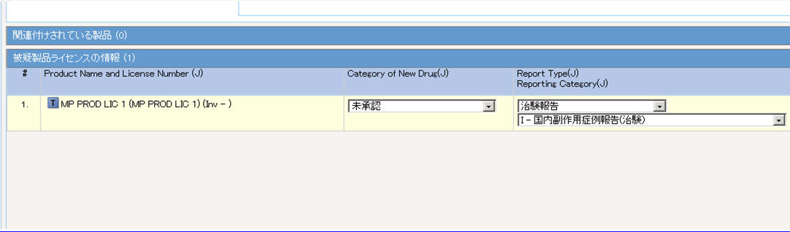

Reporting Category:
The Reporting Category is a drop-down list with the values from Reporting Category Code List.
- The Reporting category is a drop-down list with the values, as indicated in the table below. The drop-down content of the field depends on the previous selection in:
- AE/Infection (in Infection check box in Event tab) - This is used only if all the events are AE, or all the events are Infection.
- Domestic / Foreign (in Country of Incidence, PMDA tab, Dom = JP, Frgn <> JP)
- License Type (Investigational or Marketed)
- You can refer to the following table for the list of Reporting Categories in the drop-down list.
- The system clears the Japan Reporting Category if the dependent fields are modified after the selection has been updated.

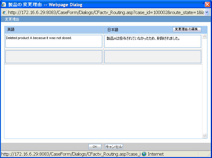

Product Change Justification:
- When you click the OK button (the button appears in each follow-up row of Product Change Justification column in the follow-up info table), the Justification Table pop-up is displayed to view update information.
- The button is enabled only when Product Change justification exists for the case.
For example, Scenario # 1 - it only asks for justification if there is a submitted report against the product which is subject to deletion and you unlock the case with follow-up to delete that product.
Scenario # 2 - In addition, when you create a company product:
- Schedule an Expedited report against the company product.
- Get that report to Submitted status.
- Unlock case a, add follow-up and change the company product to a different company product (change justification is displayed).
- Enter something and navigate to PMDA tab.
- The button is enabled.
- The Justification list populates all the product justifications entered for the follow up.
- The Translation justification is editable using the following steps:
- Select the justification from the list. This highlights the row.
- Click the Editing the justification button.
This opens Justification pop-up and you can edit the justification.

- Once you select Research Reporting Category and enters the reason, and then re-selects the Reporting Category to Non-Research Reporting Category, the system displays a warning message:
Trying to select non-Research Reporting Category. If changed, the already entered "Reason of the Research Report" will be removed. Continue? is displayed.
If you select OK, the reason is deleted. If Cancel is selected, the Reporting Category change is aborted.
- The pop-up UI section opens only when any one of the suspected drug license table
has one of following Reporting Category
selected:
