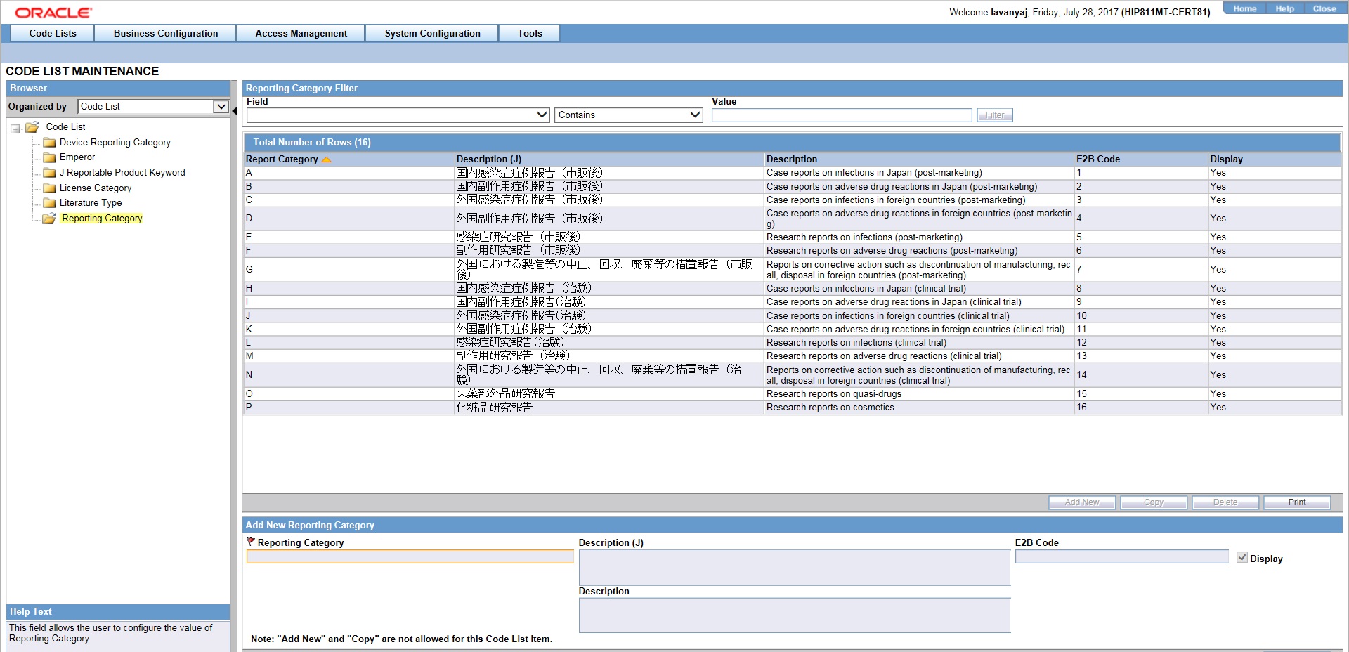

Use the following procedure to configure action taken:
  1. From the Oracle Argus Safety Console, select Code Lists > Argus J > Reporting Category.
  2. When the system opens the Code List Maintenance screen, click Reporting Category in the Code List in the left pane.
  3. The system puts the corresponding data for the selected item in the right pane.
    Reporting Category Code List screen
  4. This screen enables you to view the English and Japanese names of the configured categories. You can also set the display preferences for these code lists.
  5. Click Save to save any changes.
