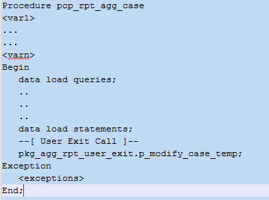

You can use user exits to customize BIP Periodic Report data present in the GTT and RM Tables. Every population algorithm contains a user exit at the end during the database selection. A user exit lets you:

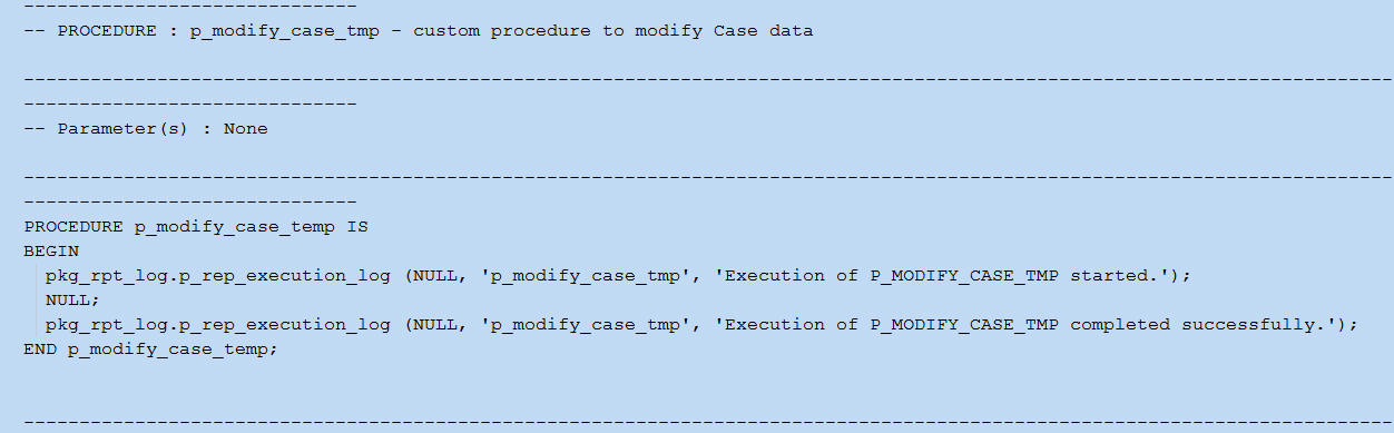

Figure 6-2 displays the structure of an out-of-the-box user exit.
Figure 6-2 Structure of an Out-of-the-box User Exit
Description of "Figure 6-2 Structure of an Out-of-the-box User Exit"
Figure 6-3 Structure of an Out-of-the-box User Exit
An out-of-the-box user exit only has a null statement between the log handlers. You can add logic (as necessary) to insert, update, or delete rows from corresponding or related tables.
