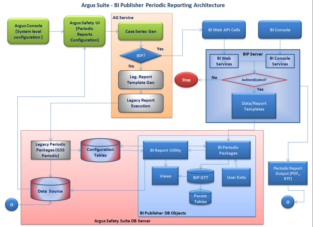

Figure 3-1 displays the architecture of BI Publisher Periodic Reporting with Oracle Argus Safety.
Figure 3-1 Argus Flexible Aggregate Reporting Architecture
Description of "Figure 3-1 Argus Flexible Aggregate Reporting Architecture"
Oracle Business Intelligence Publisher reports can be executed from Oracle Argus Safety UI or through the Oracle Business Intelligence Publisher console. The following table explains the core components involved in the architecture diagram.
Table 3-1 Core Components of the Architecture Diagram
| Component | Functionality |
Argus Web Console |
The first piece of the application for configuring Oracle Argus Safety. Handles the following: - Enabling the BIP module - Supplying the necessary BIP security credentials and setting up the persist duration - Setting up the report template path |
Argus Web |
Provides the report configuration for ICH PSUR and CTPR reports. Supplies the criteria that generates the case series. The batch print screen runs either a legacy periodic report or a BIP report based on user selection. It also lets you generate or reuse already generated case series. |
AG Service |
Internally invokes the BIP Periodic report through WebServices and runs the report in the background. |
Argus Database - BIP Schema |
New schema created during the schema creation that holds all objects used for generating the periodic reports. The objects in the schema are responsible for generating the data needed. |
BIP Server |
Server where Oracle Business Intelligence Publisher reports are located and executed. Report output is temporarily stored in the BIP server. |
