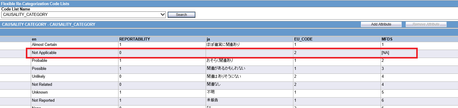

To achieve this, Oracle Argus Safety Flexible codelist is enhanced with additional values in Console > Codelist > Flexible re-categorization > CAUSALITY_CATEGORY:
- New attribute MFDS is added.
- Existing attribute E2B R3 is updated for the additional values.
When a Medical Reviewer assesses Case Form > Event > Event Assessment > Causality as Reported Result and Causality as Determined Result, the MFDS specific codes are populated by out-of-the-box mapping logic in Regional Causality Assessment elements.
For Null flavor [NA], configure a flex codelist with MFDS code as [NA]. This is not provided out-of-the-box.
For details, refer to the Business Rules defined in E2B(R3) export mapping document.

| CODE | En | REPORTABILITY | Ja | EU_CODE | MFDS |
| 1 | Almost Certain | 1 | 1 | 1 | |
| 2 | Probable | 1 | 1 | 2 | |
| 3 | Possible | 1 | 1 | 3 | |
| 4 | Unlikely | 0 | 2 | 4 | |
| 5 | Not Related | 0 | 2 | 4 | |
| 6 | Unknown | 1 | 1 | 5 | |
| 7 | Not Reported | 1 | 1 | 6 | |
| 8 | None | 0 | 2 | 6 |
