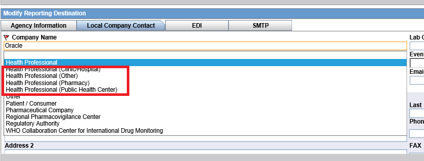

To achieve this, Oracle Argus Safety Flexible code list is enhanced with additional values in Console > Code Lists > Flexible re-categorization > REPORTING_DESTINATION_TYPE:
- The new MFDS attribute is added.
- The existing E2B(R3) attribute is updated for the additional values.
It is recommended to set the Console > Reporting Destination > Local Company Contact > Sender Type according to the Sender Type, so that C.3.1 will be transmitted as 3 (Health professional) and C.3.1.KR.1 will be transmitted as corresponding MFDS attribute value.

| CODE | En | Ja | E2B_R3 | MFDS |
| 1 | Pharmaceutical Company | 1 | - | |
| 2 | Regulatory Authority | 2 | - | |
| 3 | Health Professional | 3 | 4 | |
| 4 | Regional Pharmacovigilance Center | 4 | - | |
| 5 | WHO Collaboration Center for International Drug Monitoring | ![]() |
5 | - |
| 6 | Other | 6 | - | |
| 7 | Patient / Consumer | 7 | - | |
| 8 | Health Professional (Clinic/Hospital) | 3 | 1 | |
| 9 | Health Professional (Pharmacy) | 3 | 2 | |
| 10 | Health Professional (Public Health Center) | 3 | 3 | |
| 11 | Health Professional (Other) | 3 | 4 |
