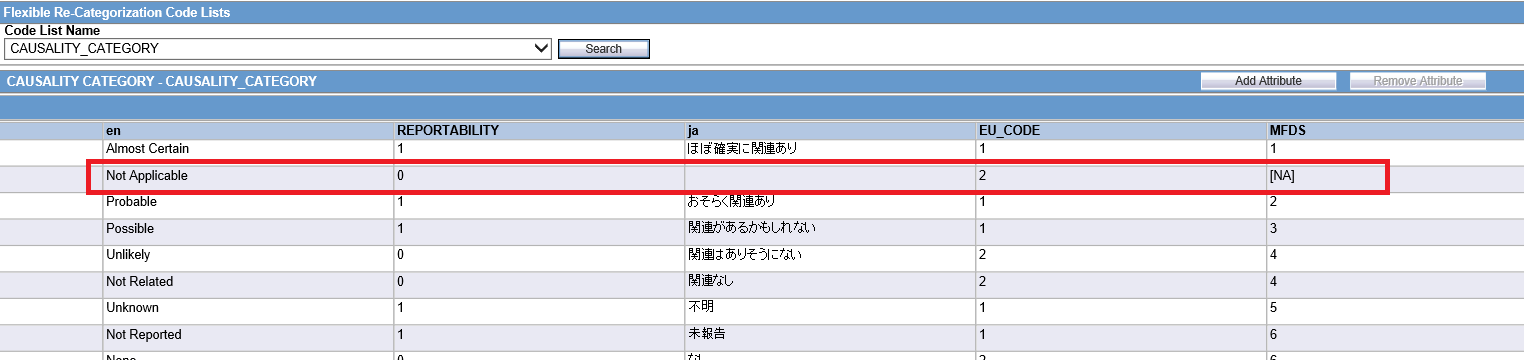

To achieve this, Oracle Argus Safety Flexible code list is enhanced with additional values in Console > Code Lists > Flexible re-categorization > CAUSALITY_CATEGORY:
- The new MFDS attribute is added.
- The existing E2B(R3) attribute is updated for the additional values.
When a Medical Reviewer assesses Case Form > Event > Event Assessment > Causality as Reported Result and Causality as Determined Result, the MFDS specific codes are populated by out-of-the-box mapping logic in Regional Causality Assessment elements.
For Null flavor [NA], configure a flex code list with MFDS code as [NA]. This is not provided out-of-the-box.
For details, refer to the Business Rules defined in the E2B(R3) export mapping document.

CODE | En | REPORTABILITY | Ja | EU_CODE | MFDS |
1 | Almost Certain | 1 | ![]() |
1 | 1 |
2 | Probable | 1 | ![]() |
1 | 2 |
3 | Possible | 1 | ![]() |
1 | 3 |
4 | Unlikely | 0 | ![]() |
2 | 4 |
5 | Not Related | 0 | ![]() |
2 | 4 |
6 | Unknown | 1 | ![]() |
1 | 5 |
7 | Not Reported | 1 | ![]() |
1 | 6 |
8 | None | 0 | ![]() |
2 | 6 |
