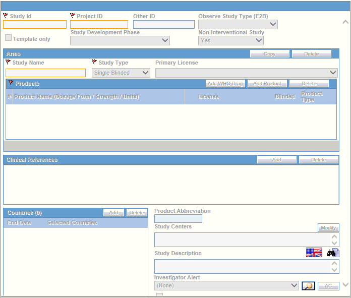

It is important to configure clinical studies in the Argus Console because it helps the system categorize the source of information for the cases that have been registered. This screen helps in capturing Study information (study specifics, products involved in the study licensed countries associated with the study and the clinical references used in the expedited reports.
Configuration of the product is done using the Business Configuration > Studies section.

The following illustration shows the fields associated with this section.
