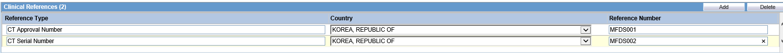

To achieve this, set up the MFDS specific numbers in Console > Study Configuration > Clinical References section:
- To transmit Clinical Trial Approval Number issued by MFDS in C.5.1.r.1, select Reference Type = CT Approval Number, and enter the Reference Number for Country = Korea, Republic of.
- To transmit Clinical Trial Serial Number issued by MFDS in C.5.3, select Reference Type = CT Serial Number, and enter the Reference Number for Country = Korea, Republic of.
- To transmit Clinical Trial Plan Number issued by MFDS in C.5.3, select Reference Type = CT Plan Number and enter the Reference Number for Country = Korea, Republic of.
