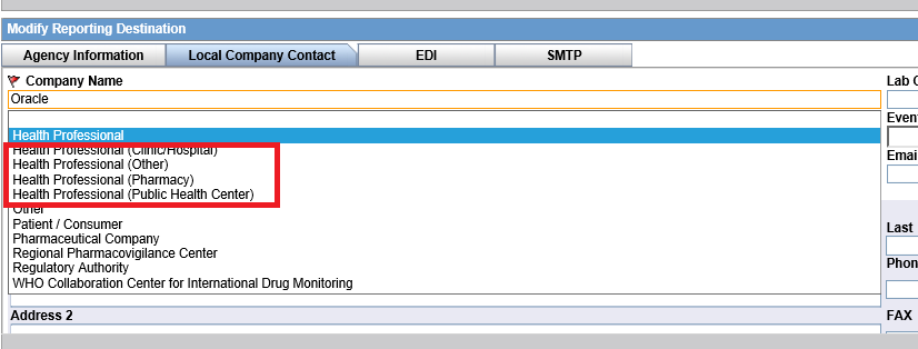

11 Health Professional Type (C.3.1.KR.1) for cases with Health Professional Sender Type
Whenever Sender Type is Health Professional with C.3.1 = 3 (Health professional) as set in the Console > Reporting Destination > Local Company Contact > Sender Type, it is mandatory to transmit HEALTHPROFESSIONALTYPE [C.3.1.KR.1].
Element ID | Element description | Allowed Values |
C.3.1.KR.1 | Health Professional Type | 1=Clinic/Hospital
2=Pharmacy 3=Public Health Centre 4=Other |
To achieve this, Oracle Argus Safety Flexible code list is enhanced with additional values in Console > Code Lists > Flexible re-categorization > REPORTING_DESTINATION_TYPE:
- The new MFDS attribute is added.
- The existing E2B(R3) attribute is updated for the additional values.
It is recommended to set the Console > Reporting Destination > Local Company Contact > Sender Type according to the Sender Type, so that C.3.1 will be transmitted as 3 (Health professional) and C.3.1.KR.1 will be transmitted as corresponding MFDS attribute value.
What this means to business users: No additional data entry required (and derived from configuration).
